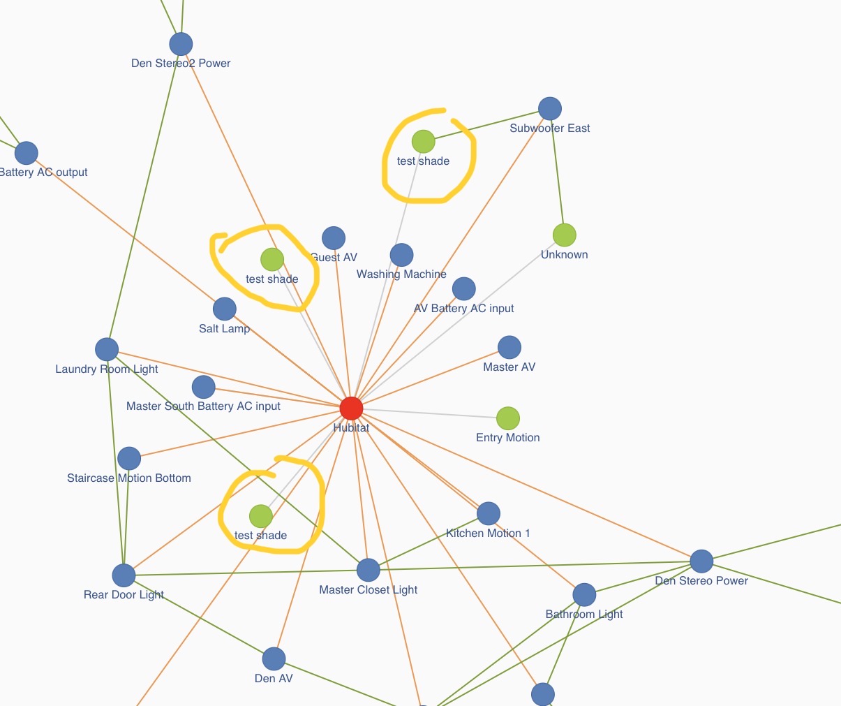

The infoaddress changed! events when the zigbee radio is in pairing mode i think are odd, and this morning i realized the zigbee map does a good job visualizing why I think the events are odd.
