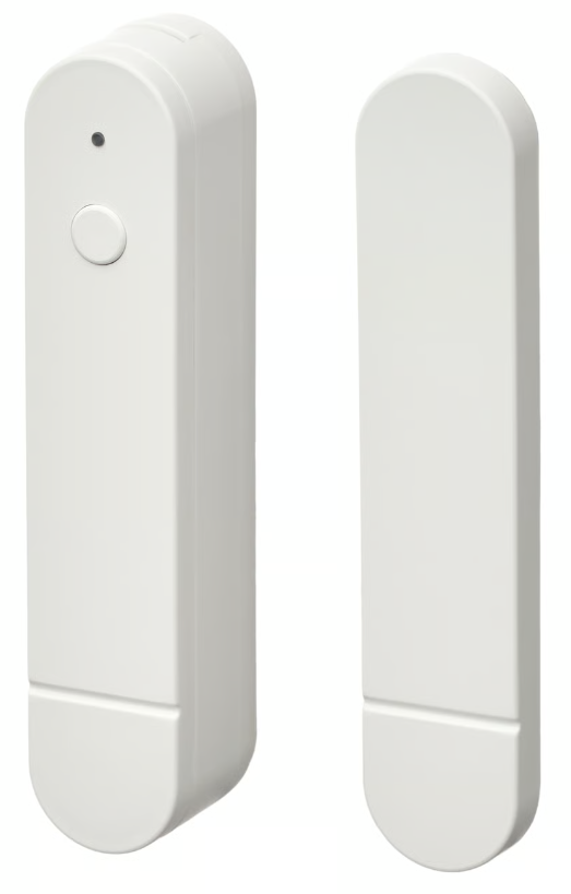

My take: Works fine. Slightly larger than most contact sensors. Has a front-facing setup button and LED which I like. The battery compartment is not accessible from the front. Rather, the sensor side comes apart to reveal the battery compartment which has a cover as well. Like several of the IKEA devices, a small screwdriver is really needed to change the battery (1 AAA) rather than sliding the front cover off as in most sensors.
Mounts with 3M adhesive strip. Some reviews complain that you have to mount the magnet to be flat against the sensor, but as long as the locator bars match up, the sensor reads just as well on the side.
