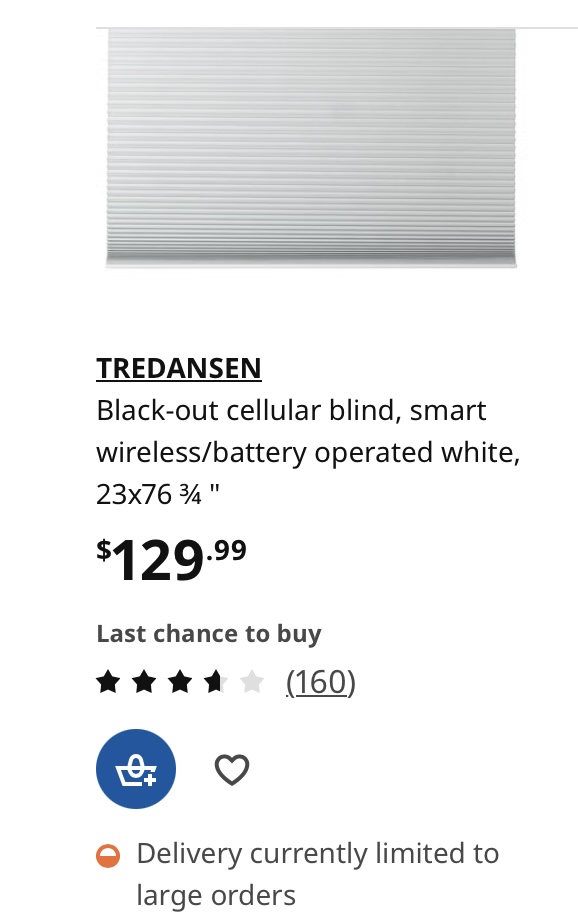

Went to IKEA this morning. No FYRTUR smart blinds even in the clearance section. So, I found the TREDANSEN smart blinds and was able to get a full credit on the FYRTUR.
The TREDANSEN paired easily to HE, and work fine using the ‘IKEA window blinds’ driver. They are a little slower going up and down. A little quieter too.

I just had another Frytur motor go bad and, though it took some effort, IKEA is giving me store credit from the purchase four years ago. But what is there to buy? It appears TREDANSEN is being discontinued also.
SmartApfel is the rumored replacement which ChatGPT helpfully said should be out in 2024.
