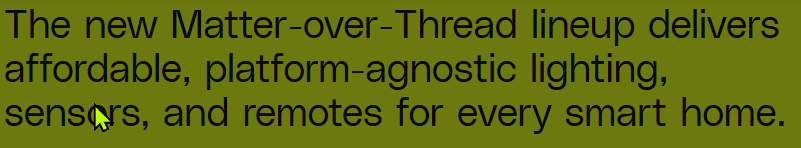

AFAICT these new devices are Matter over Thread...Verge article lead-in:
Some more reading:
So they should be installable as long as you have one or more Thread Border Routers (HomePod, Google Home, Alexa, etc.) and then you could share it to Hubitat from them. Whether the hub has a built-in Button driver for Matter that will work is another question. :slight_smile:
