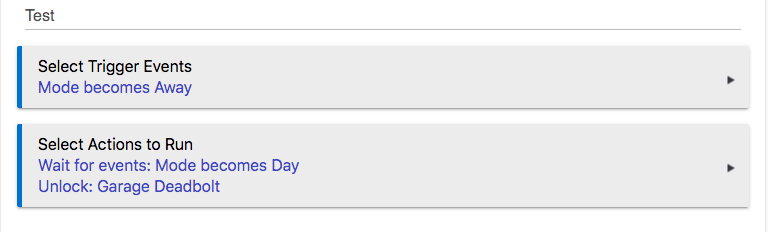

You could do something like the following.

Technically, that would also catch a mode changing to "Away," changing to something else, then changing to "Day." If you really want only Away to Day directly, you could add a trigger for almost every mode: "Mode becomes Away" OR "Mode becomes Night" OR "Mode becomes XYZ" (everything execpt Day mode as above, or whichever one you care about it changing to), then use an IF to test for the current mode. A "Wait" gets cancelled any time a trigger fires, so the doing of the "other stuff" here won't happen, and as before, the Wait still won't get scheduled unless the mode is Away:
IF (Mode is Away) THEN
  Wait for Events: Mode becomes Day
  Do other stuff
END-IF
Just an idea if this matters!

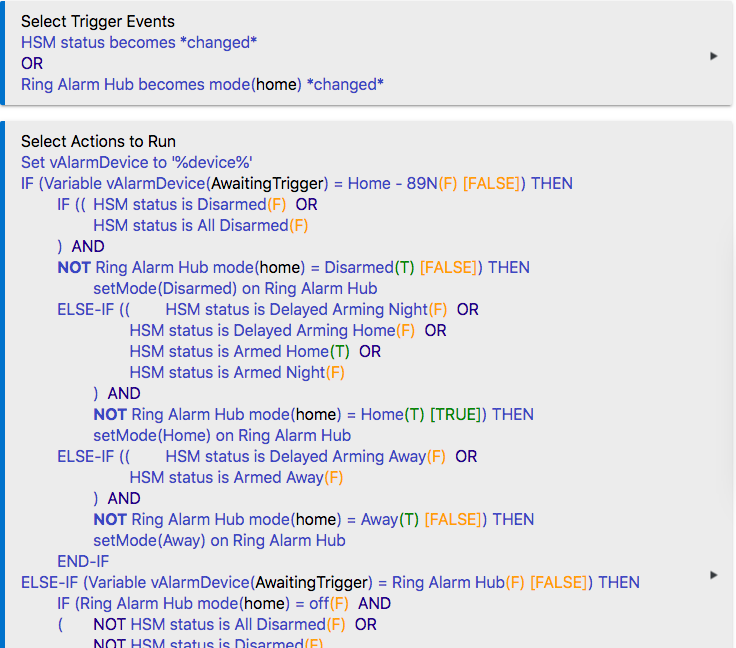

Agreed, I was just trying to put them on the right track. This is why I use variables in some cases. Below is a snippet of where this can come in handy.

So from my understanding this should be the proper setup: (I have 3 modes Away/Home/Night)
Trigger Events
  • Modem Becomes Away
    OR
  • Mode Becomes Night
Select Action to Run
  Wait for Events: Mode becomes Home
  Unlock the Door
END-IF
Separately, is their an easier method for rule machine to determine the following scenario. If the current mode is Home and home is called again then DO SOMETHING?
That looks right to me! (Actually it looks odd because it may seem like nothing gets rid of that "Wait," but any trigger firing will indeed get rid of any Wait in progress, so it should work. If you get farther into Rule Machine, Delays are different and do not work like this.)
