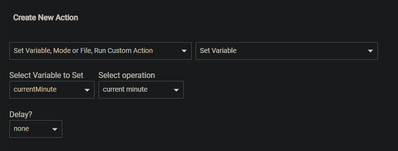

webCoRE has a built-in $minute system variable. Is there something similar in Rule Machine? Or can you parse the time and make your own minute variable?
That's what Robert recommended above. There's an option to set a variable to the current minute.
Where is the option to set a variable to the current minute?
:flushed:
Thanks!
