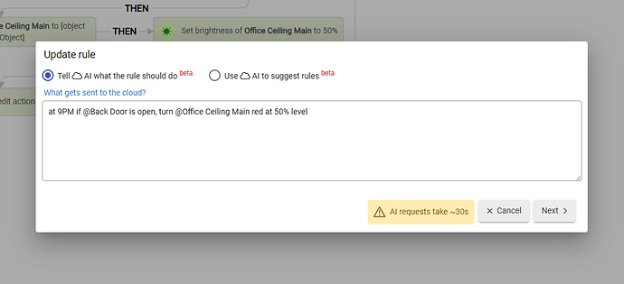

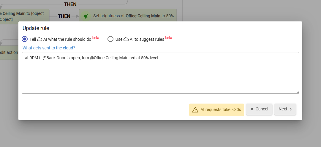

If you ask Gemini today, it will tell you to do this
But soon you'll be able to do this right from the hub:
Today you can achieve that use case with Basic Rules app
That is really cool!
Thanks so much. When do you think I will be able to do it from the hub?
Now we're getting into A Connecticut Yankee in King Arthur's Court level magic.
It will be included in the next update. As usual, it will first roll out to the beta channel, and if everything goes well, it will be made available to the public (a typical beta cycle lasts a few weeks).
Update: the AI integration is now available in beta: 🤖 Smarter Automations Ahead — AI Rule Building Meets Local Control

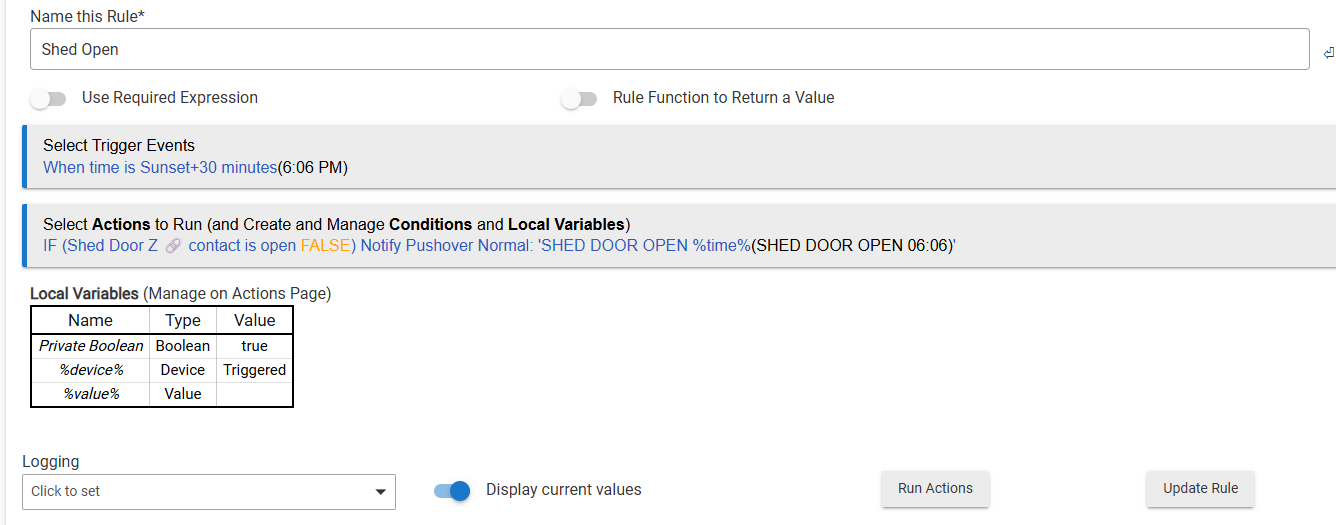

I thought that this was to be easy - but I can set an alert if (say) a contact is opened after a particular time BUT if the contact if already open before the time and then left open, I can't get the alert.
