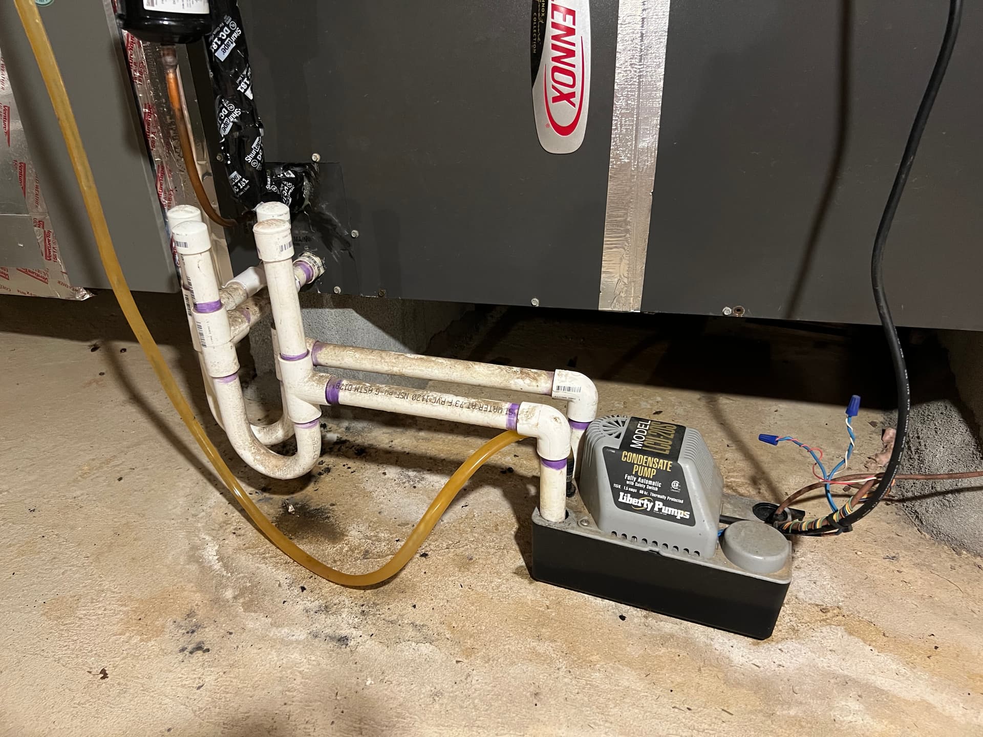

Totally understand. Stop by your local box store and look at the condensate pumps. You can run a short pipe from your tray into one of the holes on the condensate pump and then flexible tubing from the pump to the outside. It will run automatically based on the fill level. You could even plug it into a power sensing smart outlet to monitor how often it runs.
Sometimes pictures help. Here is mine

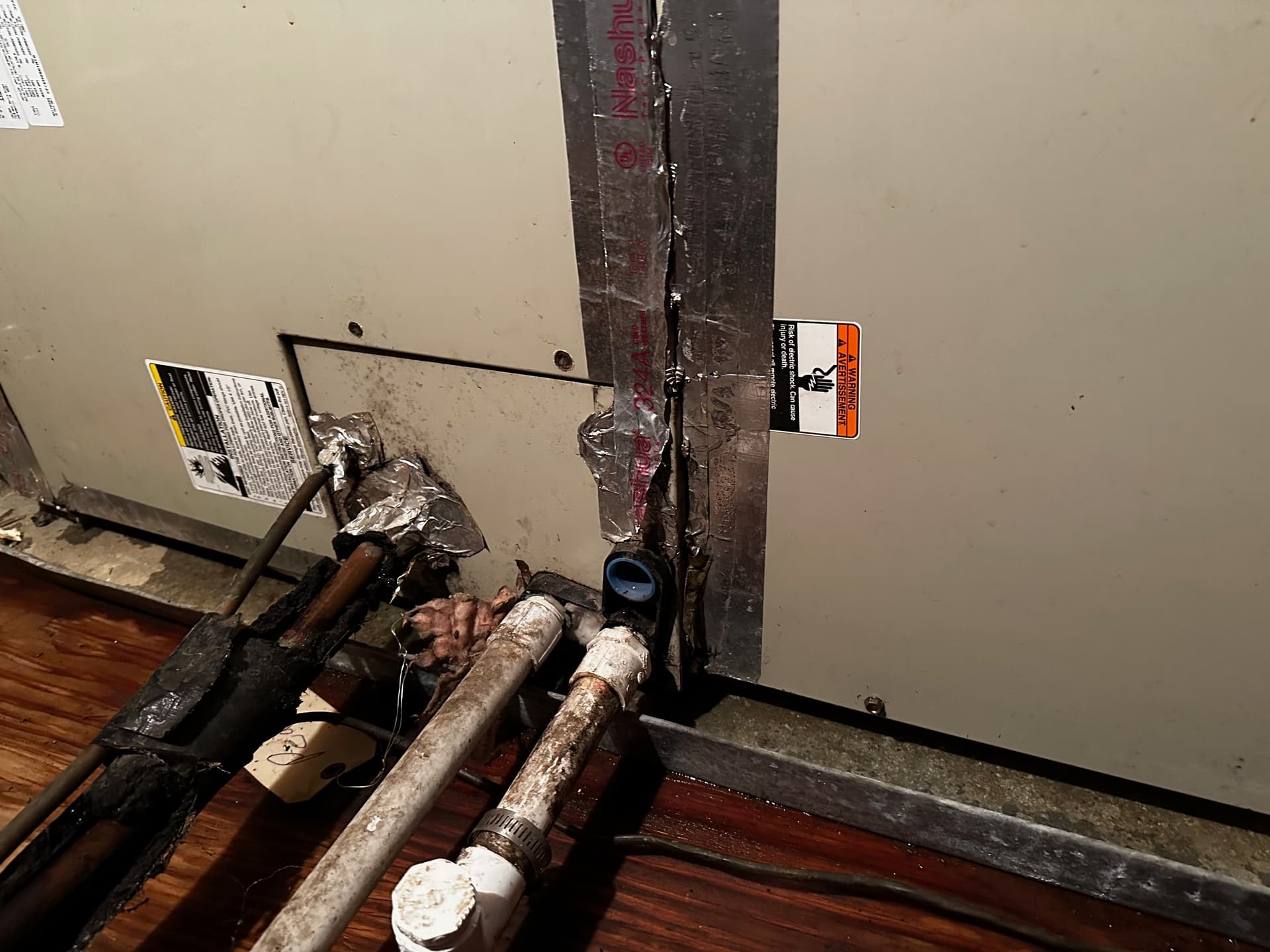

Yeah. I dont have the clearance on the pvc to run into a condensate pump. That's why I was looking to recreate the setup/concept with something that would fit. See pic. Note the water on plywood is from shop vac spills/splashes not overflow.
They make "low profile" condensate pumps too. Obviously the tank is smaller so they will run more often. They might work for you and I assume one of those PVC pipes is the clogged one and the other goes out through the soffit? You could repurpose the soffit one into the low profile pump.

I line is the main, the other is a "cleaning branch" with a port access. I have run snakes down it to no end or effect.

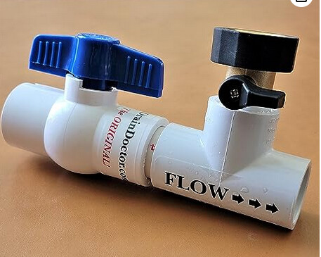

If you have PVC to the outside you can get one of these or make your own. The idea here is that you can shut off the flow on the air handler side with the ball valve and then you have a hose connector. You use a garden hose pressure to blow out the biofilm etc. After you get this cleaned out make sure you use the tablets every few months.
https://www.amazon.com/Condensate-Drain-Cleaner-Tool-Clogs/dp/B09KQTDJXF
