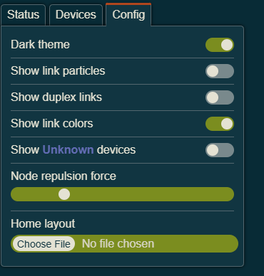

this one ?
No I am using the inbuilt "View Device Graph" option under Settings/Zigbee Details. Tempted to try the app if it will give me more info
yes install it .. and see if you get a address ..
its very good and works really well .. and you can "turn off" unknow devices.
so you can ignore them easier LOL

It didn't show the unknown device, but I get the feeling it is starting from the ones that are listed then testing their connections. My unknown device isn't even in that list. However the app has confirmed one thing I have been wondering - that Xenon power strip has more bad than good connections between it and other devices. I think it has to go. Now that does have several endpoints so if it's a "spare" endpoint problem that could solve it.
