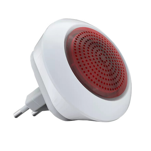

iAlarm zigbee siren (Tuya TS0224, aka Meian SR01-ZB)
Is anyone aware of a driver that works for the above?
(I've found Zigbee2MQTT drivers using Google, but drew blanks on HE drivers)

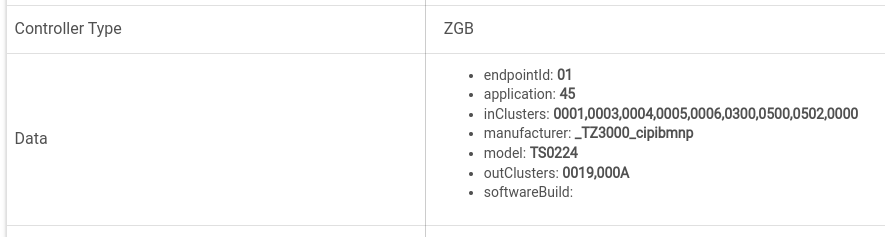

Can you post the whole device Data Details section? (found at the bottom of the device web page) ?
Of course I can!
