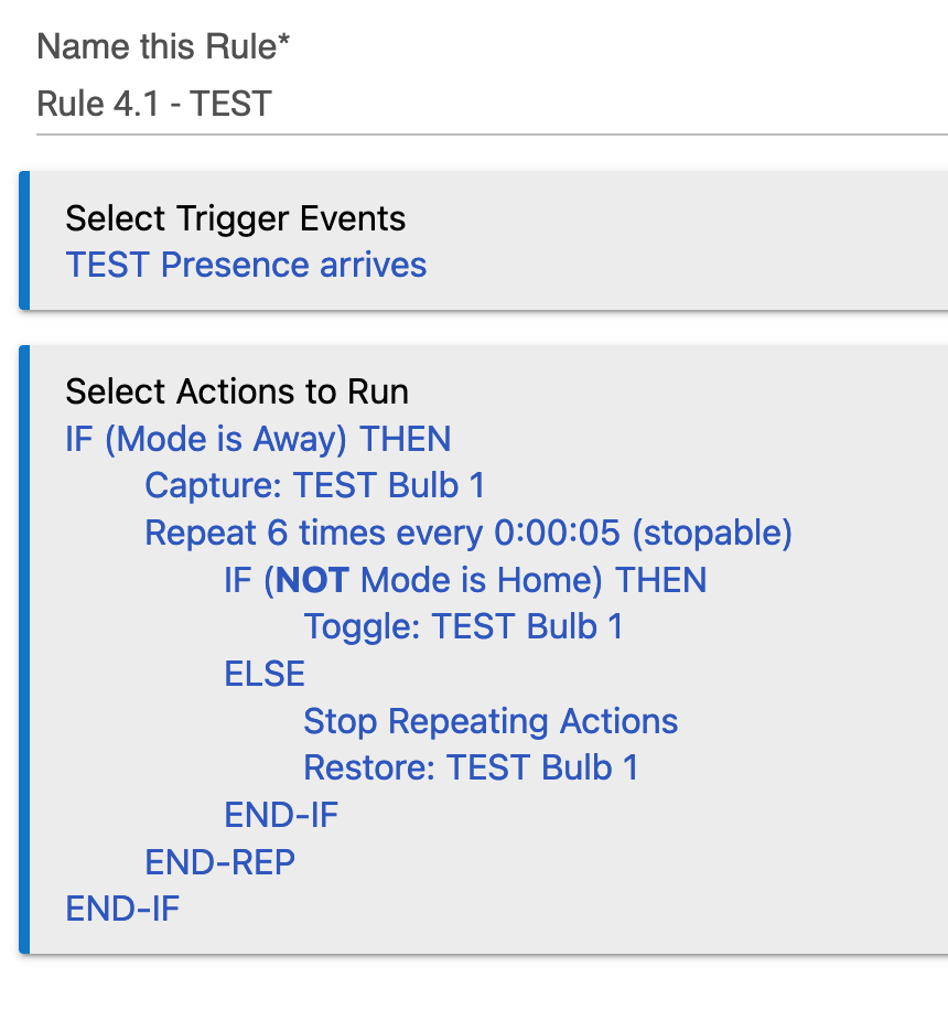

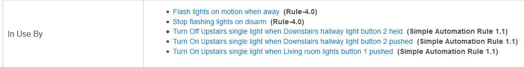

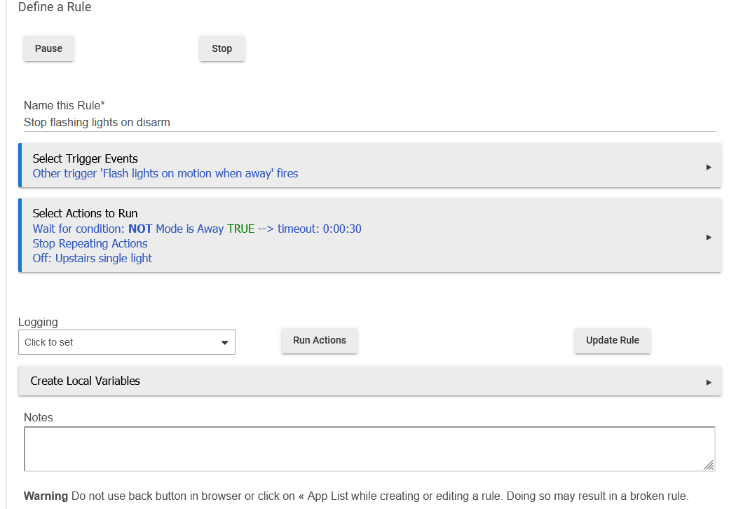

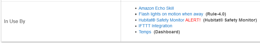

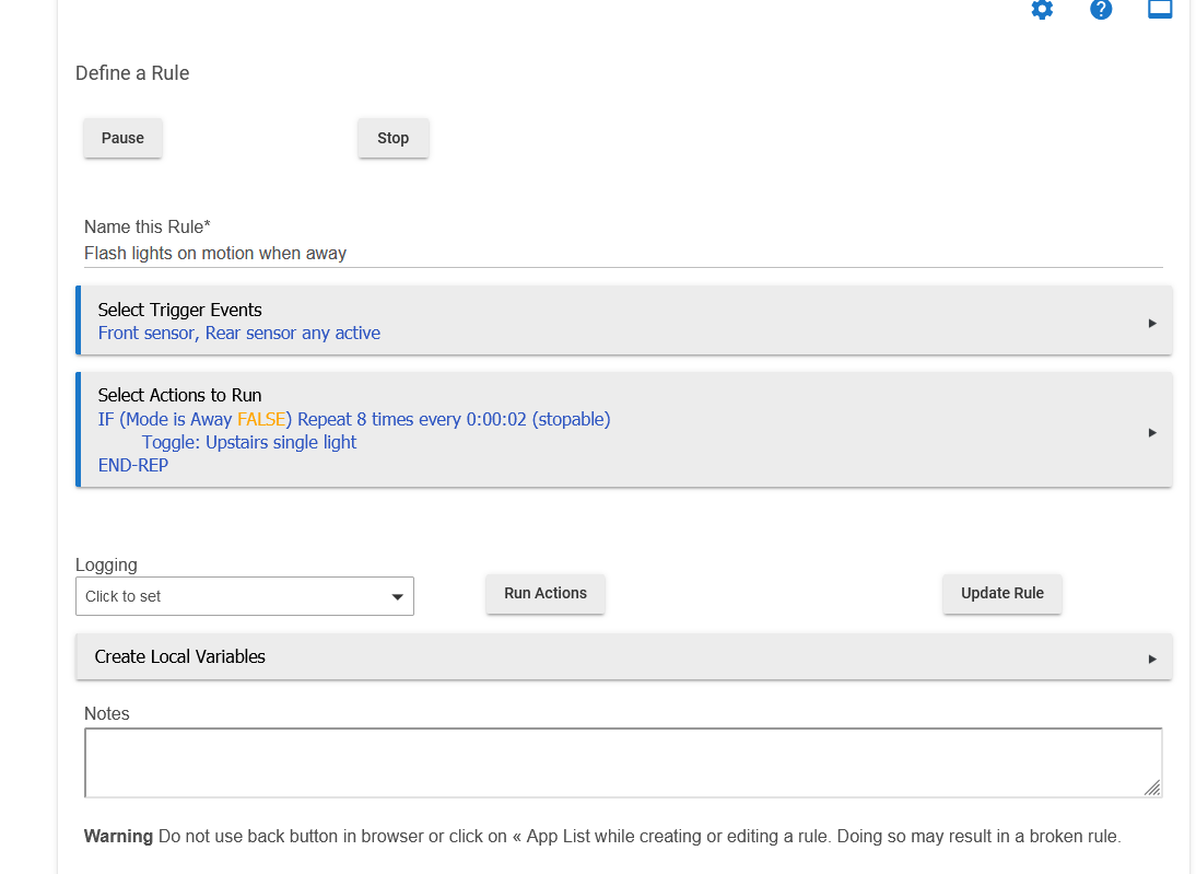

I have a light that keeps turning off when a motion sensor is triggered even though there are currently no rules for this action.
I think one my test rules that I previously deleted may be triggering this action, but I'm not sure how to debug this issue. It may either be a Rule Machine rule or a Simple Automation rule.
Logs simply show that motion is detected and light turns off.
Could you point me in the direction to try to identify what is triggering this action?
