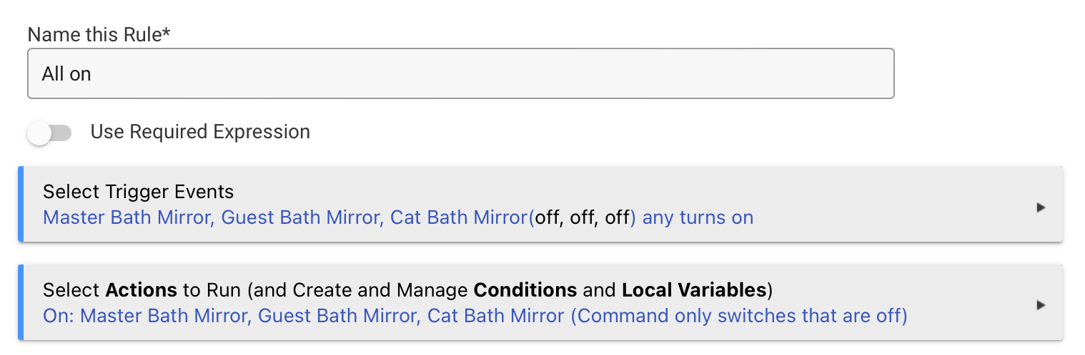

There's probably cleverer ways to do this using z-wave association, but these two rules in Rule Machine also aught to work:

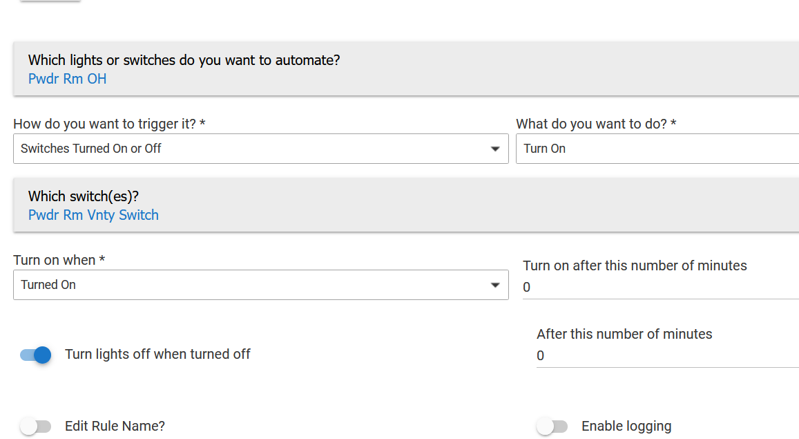

I don't know why simple automation rules wouldn't do it. I have one switch turning on two lights, itself's an another.

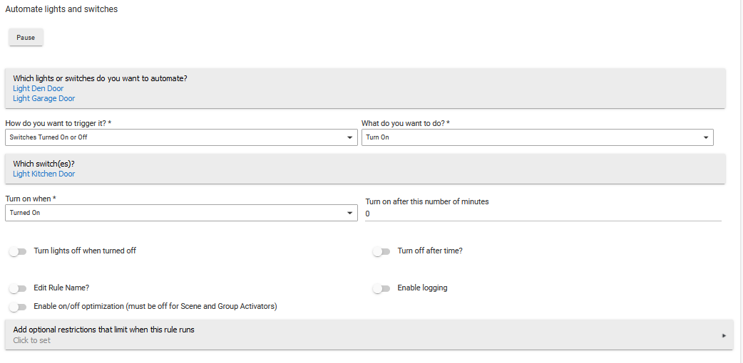

Here is what it looks like. at the moment I would settle for one switch turning on the other two lights as well. As currently configured it will only work when turned on in the app, not from the switch itself. How to I get the automation to run with the kitchen door switch is turned on?
If you setup 2 rules in Rule Machine like the ones I posted above, they will work when any of the three physical switches is turned on/off, as well as when the switches are controlled via Hubitat.
The only requirement is that the switches have to be z-wave+, i.e. report their status back to Hubitat without polling. And from your description, they are.
You don't have "turn lights off when turned off" set.
