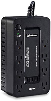

Smallest CyberPower available at 7.1 x 4.3 x 3.2 inches:
I have a few different Cyberpower models in use here and even more at customer sites. But I've not used this particular model before.

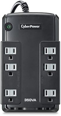

How can I tell how long it will stay powered on in a power outage?
As a UPS gets older, the batteries (unless replaced) have less capability. I've got one of the 425VA models that's a couple of days over 4 years old that's powering a router, access point, and a very inefficient cablemodem that lasted right at an hour last week during a longer outage. It's being replaced today with a 1500VA... assuming UPS gets the new UPS here on time which is likely since it shows "out for delivery". You should be able to get hours out of the 350VA when new if the only thing on it is the Hubitat.
