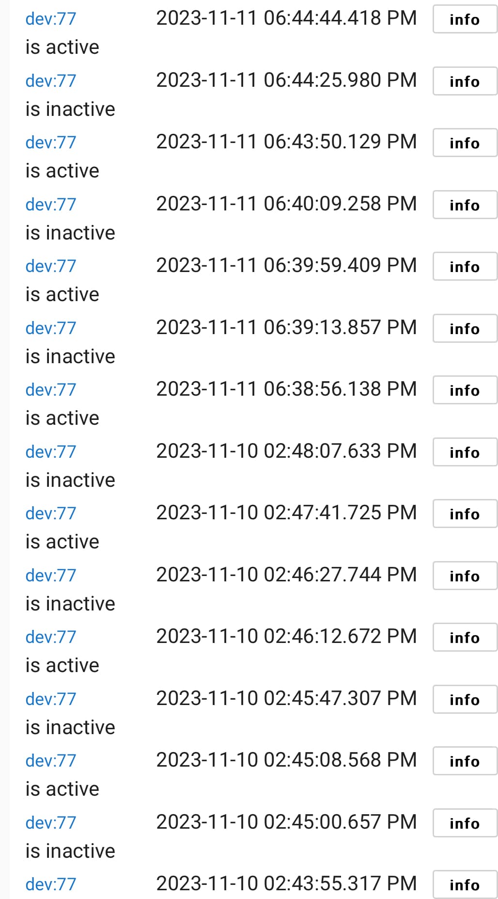

I attached the logs of one of the motion detectors that is near the hub. as you can see, it suddenly stopped logging around 2 PM and then when I rebooted it at 6 PM it resumed logging again.

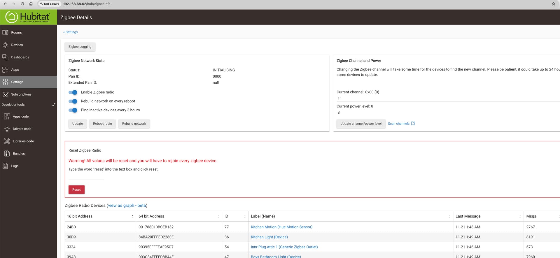

I attached power and channel settings
Channel 11 is pretty common on the 2.4 Ghz range. Even without knowing what channel the Eero is, I would switch your Zigbee channel to 20 or 25 and let your mesh restabilize afterwards. I probably wouldn't keep it at power 20 either... If it were me, I would go with something like 8 (remember, even if your hub can reach the device, the device needs to talk back to it).

I changed channel and power to what you suggested. However, that didn't solve the problem.

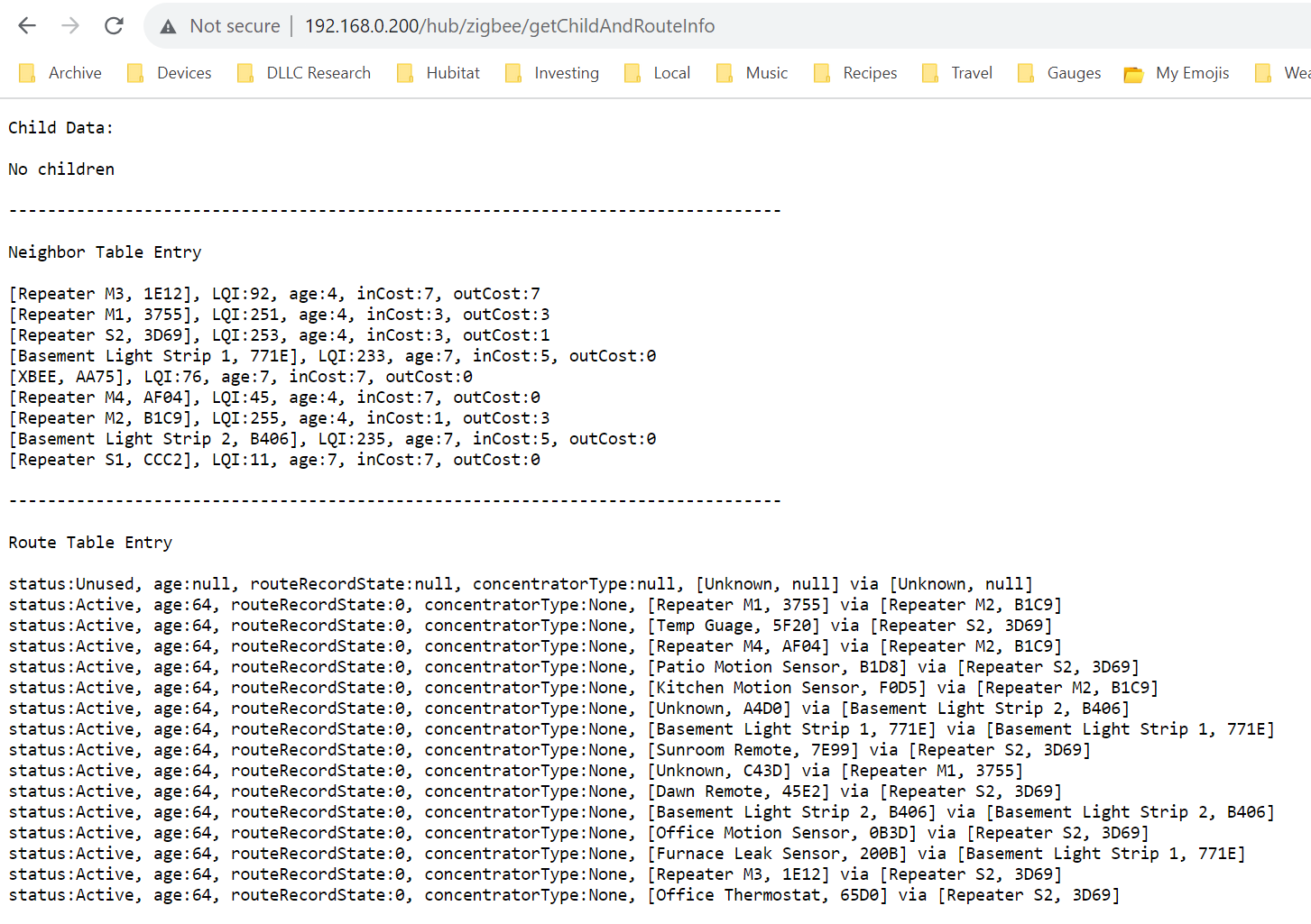

The URL took me to this page which looks different that your table
The endpoint you want to use is:
http://your-hubitat-ip/hub/zigbee/getChildAndRouteInfo
(replace your-hubitat-ip with the IP address of your hub)
These are the devices
You have 5 neighbors, all repeaters. All your other devices come through one of them as the last hop. I'd look at the routing table and see which devices connect via you lowest LQI repeaters.
