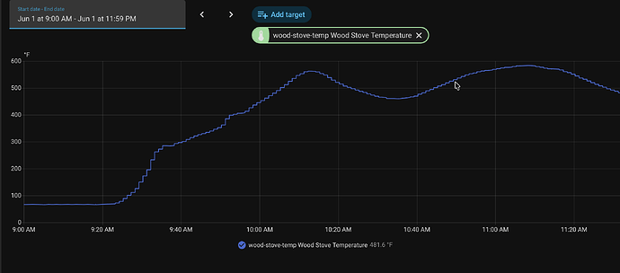

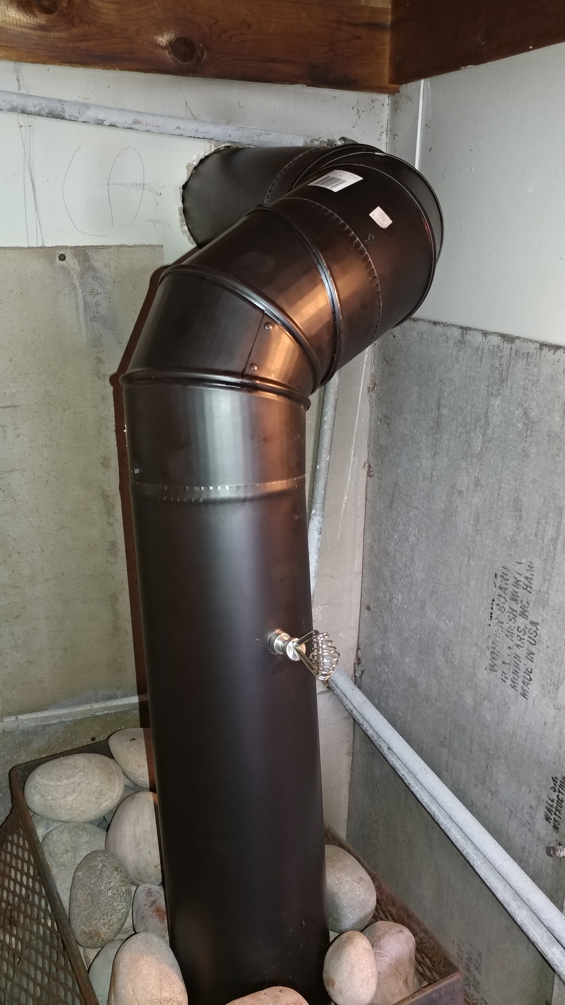

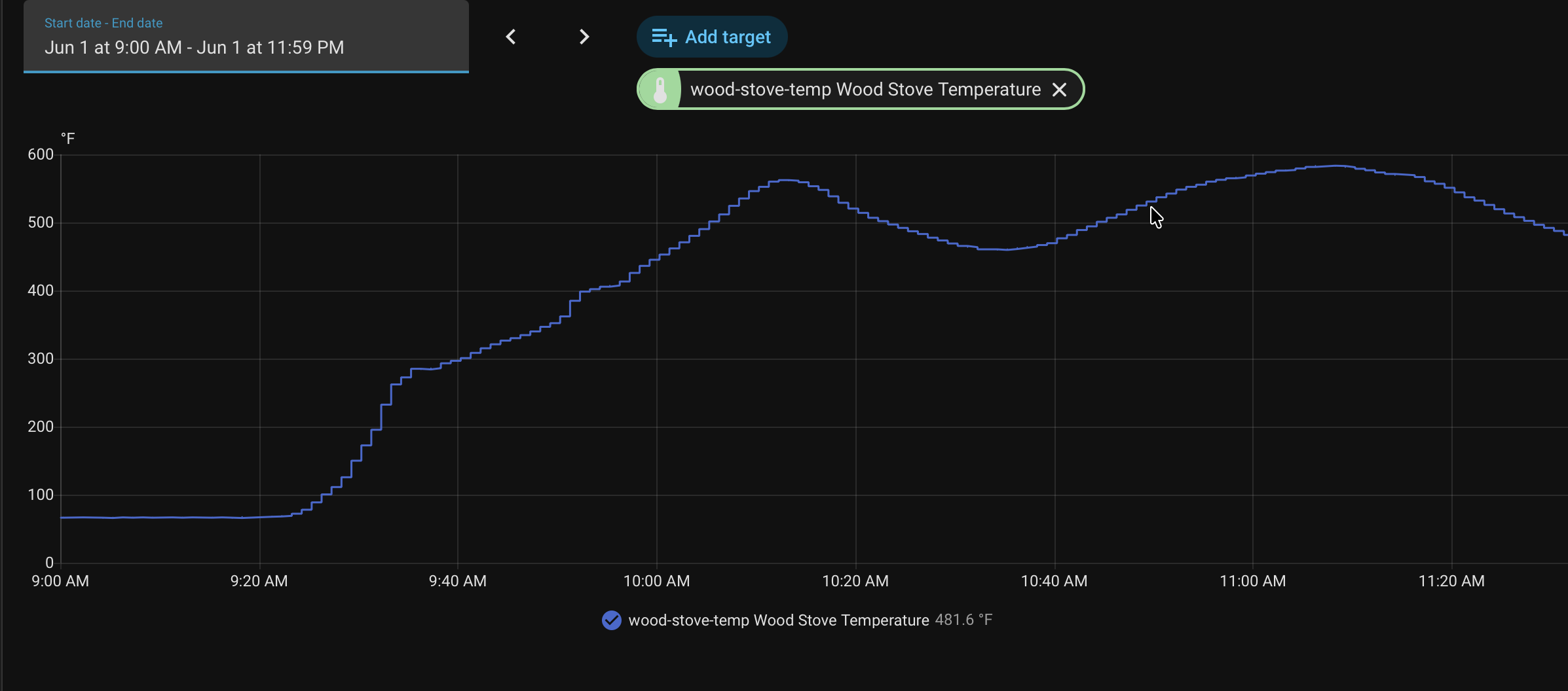

I Finally Did It: Wood Stove Temperature Sensor
First I want to thank @djh_wolf and @nclark for the inspiration to finally get off my a$$ and do it. Plus all the others who helped me with HA and the like.
I got a SeeStudio ESP32c development chip with the lugs already soldered to the pins. A Max6675 thermocouple with a K-type probe. I used ESPHome Builder to flash the device and add to HA. And then HADB to bring it into Hubitat. A little problem with excess decimal places, but there’s a workaround.
Now I have to figure out how to package it, lol.
First time doing this. Made a least one stupid mistake, but it got done.

Note also that the Nesso has a mechanical front button (the greenish bar) and the display screen is a programmable (touch, hold, etc.) touch screen, so you could, for example, use the touch interface to toggle the screen on or off, and the front button to activate some other device/automation. The device can be more compact than shown in the image, because the bottom third can be removed (it stores the LoRa antenna).
what's the temp range b4 it melts
Don’t know, lol. The cable has a metallic jacket. Type K goes to, what, 1200F, not sure, but weak point is cable. The thermocouple probe I have now on my wood stove has seen 900F, lol. This one was cheap, and probably not long enough.
would be nice to put one in our sauna stove to warn me when I forget to put wood in soon enough and it starts going out. Rule would be complex though as I am not sure you can sense a temp drop soon enough to get there b4 there are not enough coals to keep it going .
currently I have a ecowitt wn34d mounted outside the sauna with probe inside to monitor room temp. I think it goes to 247f. I've had it up to about 225
Why not? The setup reacts pretty quick. I have refresh set for 10 seconds, for now.
I’m more worried about over firing. Your sauna stove is likely very small. Burns hot and short.
because I am not sure stove temp drops that quickly even if fire damps down?
true stove is small .. not sure sure what the max temp is?
also cable length would be an issue. not sure sensor receiver would survive inside the sauna with the heat and moisture when I throw water on the rocks
I’ve got my existing probe (for the fan) on the top plate (no drilled hole, lol). If you had access to the flue you could drill a hole and put a probe in there, sort of what I did with the VW TDI and the EGT gauge.
That’s the next frontier for me…project box I guess would be the term. Although my environment isn’t that harsh.
ya that would work … manual flue on exhaust pipe coming up out of stove. but still don't think receiver/ electronic package is rated to be in the room
It might be better if the sensor was outside and the probe extended to the inside, even for more accurate readings since it gets so hot in there. I’m on shaky ground there however, re: thermocouples.
stove with flue when I last noticed a leak and put in new pipes
It was cool here today. lol.
edit: Nice chart from HA. Haven’t install Easy Dash on HE. Are they any good?
I used a 6’ thermocouple probe on my stove.
If I had access to the pipe, I’d drill a hole, insert the probe, and screw on a nut from the inside to hole it in place.
You’d get accurate and fast readings in that location, vs the hysteresis from the stove top (which is still not bad).
It’s cool being able to ask Siri what the wood stove temperature is…from a reclining position on the sofa.
@nclark, maybe you could clue me in, somewhere, about how you did the battery monitoring. My BM-2 is nice and all, but it does phone home.
