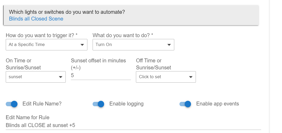

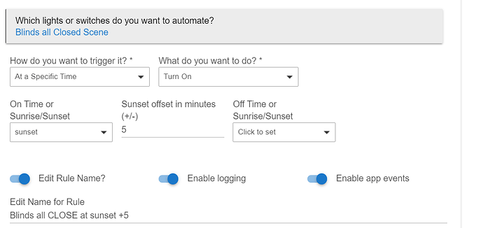

I use a simple automation to open and close my five blinds, and using scenes I've found it to be very reliable. Below is my automation to close the blinds.

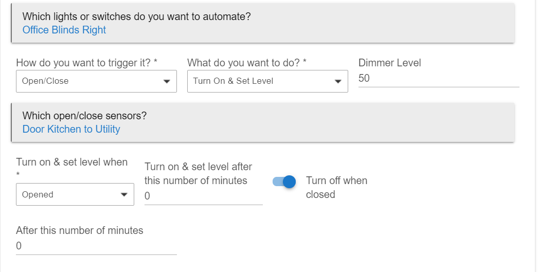

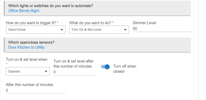

You can also treat them like a dimmer and use "Set Level" commands in apps to control them. You can also use on/off commands as if they are a normal switch. On= open to the level you set in the driver, off = closed.
Below is a quick mock-up of a SImple automation rule using set level to control iBlinds...this would open them to 50% level, and the turn off action in the automation will close them.
