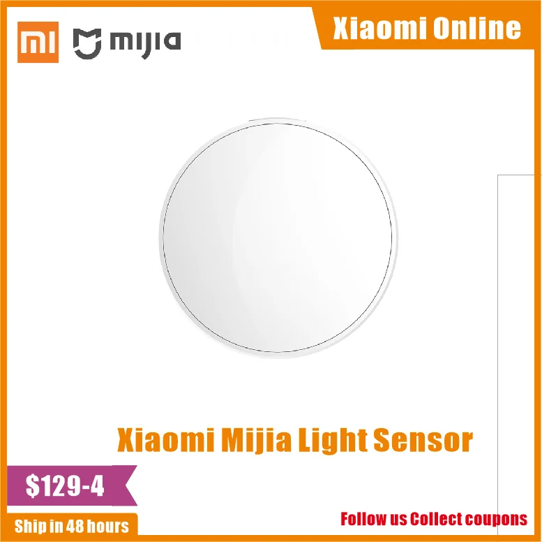

Not an offically compatible illuminance sensor, but there is a community driver for a Xiaomi Mijia light sensor. Xiaomi devices don't like incompatible repeaters and like many Zigbee devices, they will respond very poorly and tend to fall off the network if you have repeating bulbs (e.g. Not Sengled) on the same Zigbee network, so do keep that in mind.
If you keep your Zigbee network free of incompatible repeaters and bulbs, there are some Xiaomi devices that are actually quite stable. I cannot say for sure, but this light sensor might be one if you want to give it a shot. This is a Zigbee 3.0 sensor, but I have no experience with it. You can ask in the community and I'm sure you'll get feedback.

I bought 4 of the Xiaomi Mijia light sensors (model GZCGQ01LM) last year from here: ($37 for 4, or $9.25 each)
(these are the same as linked at Banggood above, but that link didn't work for me)
All four of mine were originally on SmartThings, but last month I moved the last of them over to my C-7. I was originally using Marcus' driver on them, but I've switched 2 of them to the newer, simpler unified driver by @chirpy.
They are Zigbee 3.0, but people have reported that these (like the Xiaomi Aqara sensors) can be problematic and drop off. I've not had that happen with any of mine yet, but I also use Ikea smart plugs as repeaters which seems to work well with these.
Overall, these were inexpensive and so far have been very reliable.
