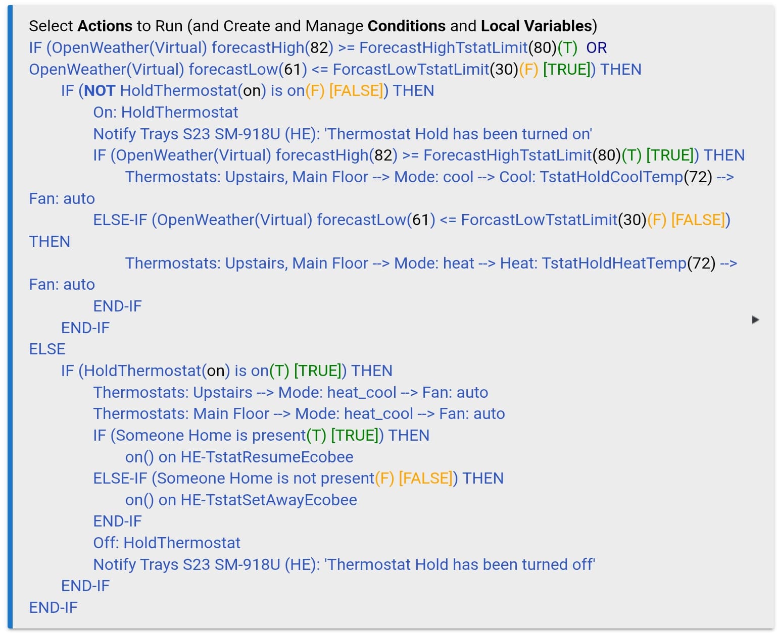

I use the predicted highs and lows to set heat/cool/auto.

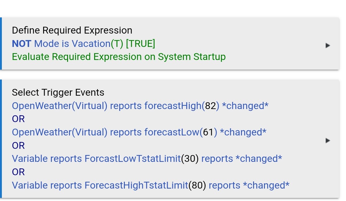

I also use hub variable to store my minimum and maximum thresholds as well as my heat and cool setpoints. I set COOL when the predicted high is over my hub variable, HEAT when the predicted low is below a certain value, and AUTO in my Goldilocks zone (neither high is above or low is below). In Auto mode, the ecobee's comfort settings take over. I also use a 2 degree difference between heat and cool in auto mode.
I also have the same rule handle the away mode (which is configure in ecobee's comfort settings). This way, it doesn't put the thermostat into away mode if the temperatures are expected to be higher or lower than my thresholds, preventing delayed recovery times.
My triggers are on updates of the forecast low or high (I have my update interval very slow - on purpose - 6 hours), or change in my global variables (the last one so that I can change it on the fly if I want)
I use the forecast for a few reasons. One: it prevents a lot of fluctuation if the outside air temperature is teetering about my thresholds. Two: even though not as accurate, if I am close enough to my threshold outside air temperature, then it doesn't really hurt to start it early/late.
My Rule

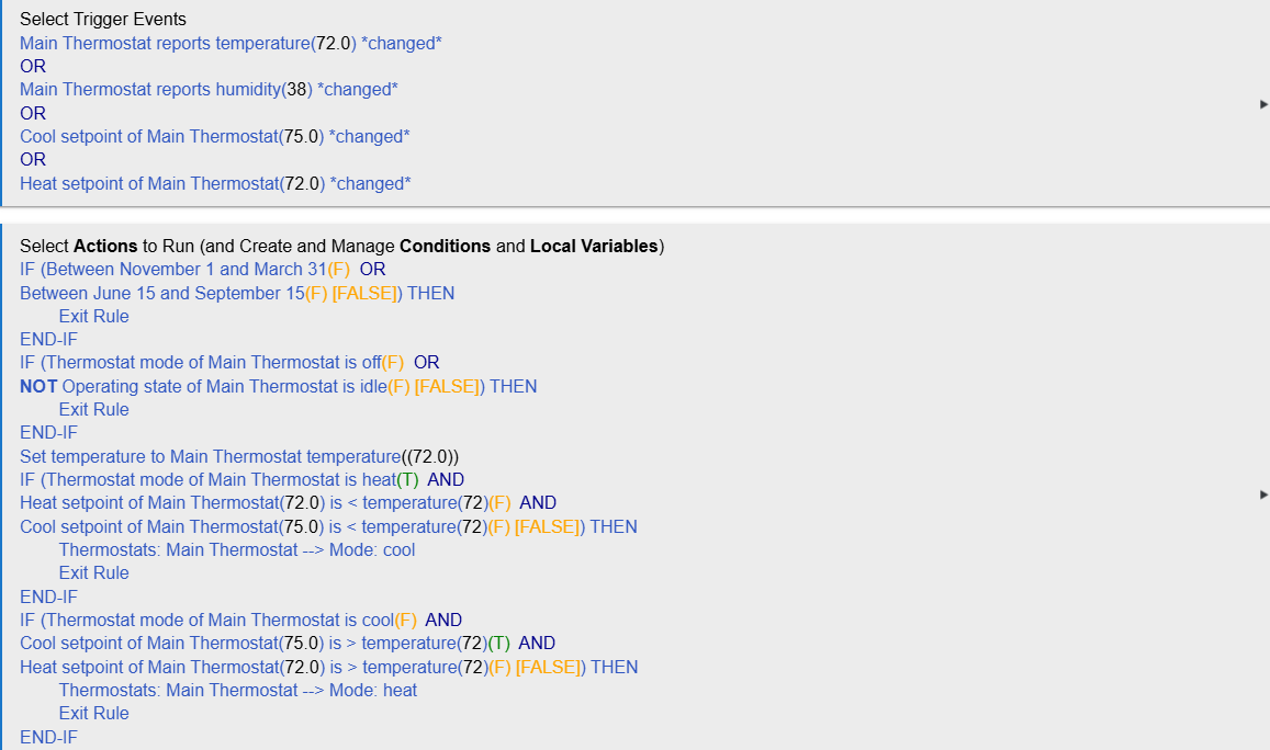

Here's mine. Only allowed during certain times of the year:
