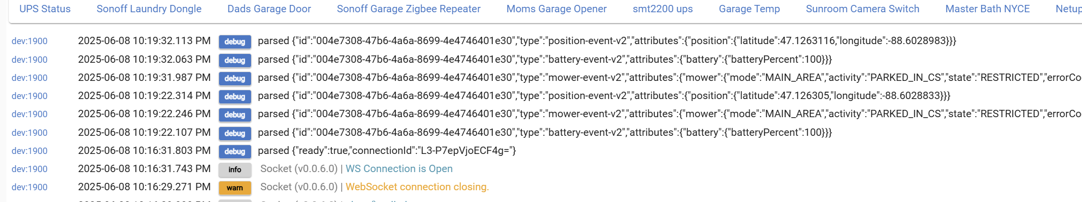

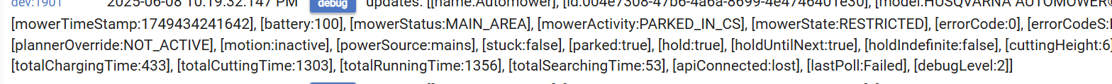

not working for me says poll failing but it does appear to be getting data via the websocket.
