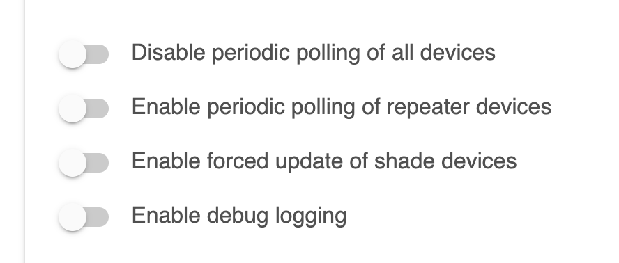

Polling settings:

Thanks @bujvary, that's my understanding as well. Unfortunately due to the instability I'm facing with forcing the refresh every 5 minutes, I would need to disable polling entirely. What I'd like to do is have a knob that controls whether or not refresh=true is provided in the API call. Ideally what it would do is:
  • if polling is enabled and forced refresh is disabled, every 5 minutes call /api/shades to update Hubitat on the cached state of the blinds. In cases where a user only uses the app (and not any remotes) this will be 100% correct and in other cases it'll offer a reasonable state of things. This should be roughly what you had in v2.3.0)
  • if polling is enabled and forced refresh is enabled, things behave as they do today
  • blind devices, when refreshed, will add refresh=true to the API call (e.g, how they behave today)

I can reimplement the forced refresh option as you suggested so that if polling is enabled and forced refresh is disabled the poll every 5 minutes will call /api/shades i.e., the hub's cached state
For battery update, I can add an interval option (in hours) in the app that will allow you to control how often the battery status update is requested.
that sounds perfect, thank you!
