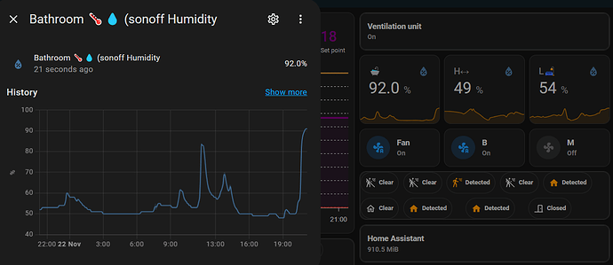

I have perhaps a similar use case. My solution was to trigger the extactor fan by both a sonoff humidity sensor and a water leak sensor in the shower. When testing the humidity sensor I used two sonoff sensors with different drivers to see which one updated more quickly. I settled on the "Tuya Temperature Humidity Illuminance LCD Display With a Clock" driver.
It's not immediate but the Extractor activates quite soon after the shower activates at above 70% rh. The sensor is above the door.

I have Aqualisa showers fitted. These were 'hardwired' in my loft space.
I installed a socket, fitted a plug to the Aqualisa shower mains lead and then plugged it in to a zigbee Salus outlet that measures power consumption.
As soon as the power draw level is above a certain value, which means the shower is on, a rule turns on the extractor fan.
I have a humidity sensor also fitted in the shower room and the extractor fan continues to run when the shower is off until humidity drops below a certain level.

I have both the switchbot meters and the sonof SNZB-02 and found them to be very reliable and accurate and each giving very similar humidity readings. Also used a Tuya humidity sensor but found it to be less reliable and readings not consistent with other two sensors.
EDIT: above should read SONOFF SNZB-02D
I have a whole house ventilation unit, and boost mode is activated when humidity is >=65% by turning on switch via a fingerbot/switchbot device.
