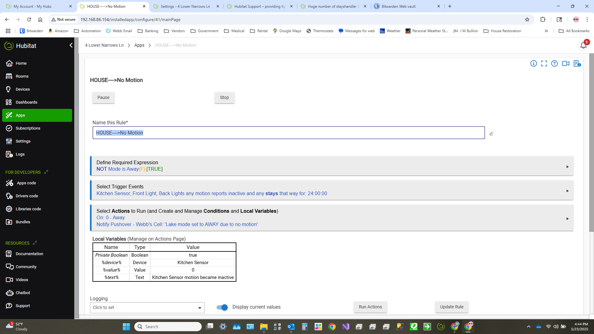

Rule in question is:

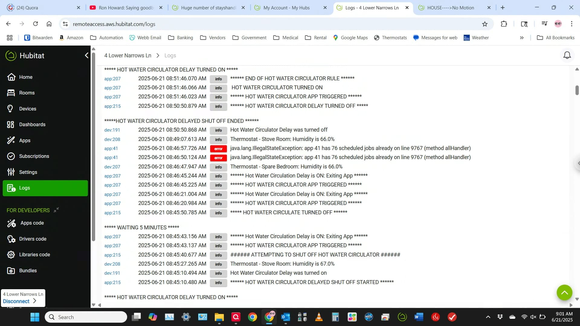

After restarting the hub, after a while the log starts showing exceptions:
And I believe it is caused by the excessive number of scheduled jobs for the rule shown above:
Every time there no motion, a new stayshandler job is scheduled for 24 hours out but none o the previous are cancelled. I never saw this before the update to the current version.

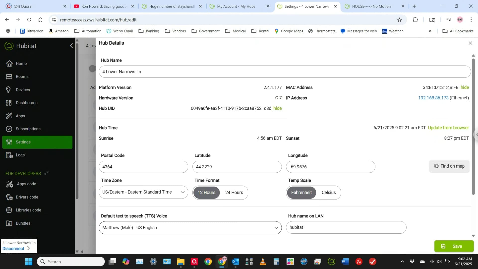

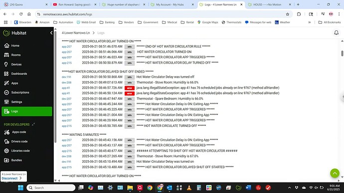

I have updated and this problem is still occurring.....what next?

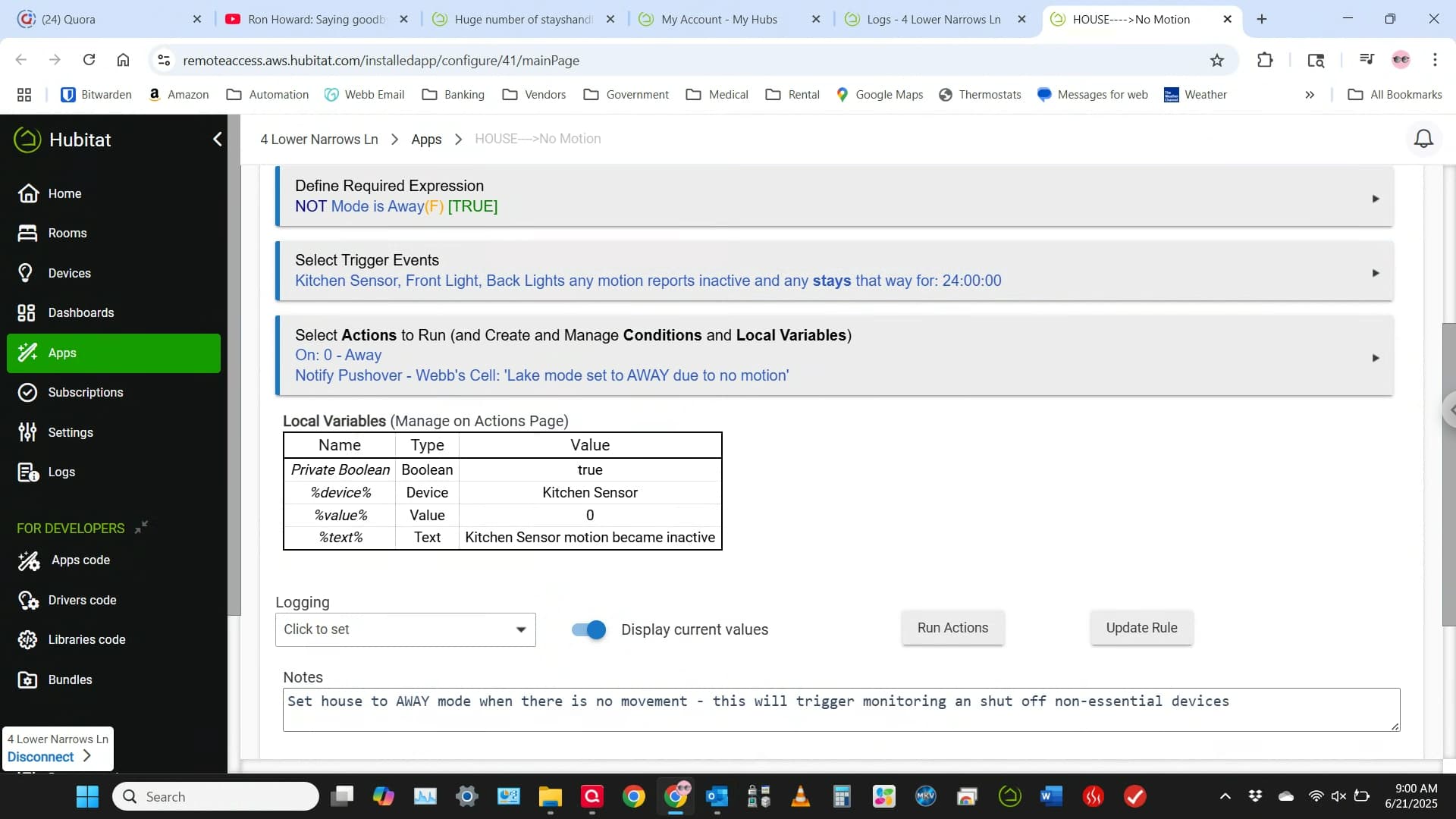

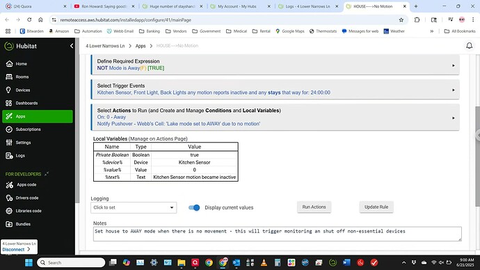

Show the rule in question.
And like I said before, this rule was running for a long, long time with no issues before.
This bug fix is in Release 2.4.2, not in 2.4.1 that you are running. 2.4.2 is in beta, due for general release next week. You can join beta if you want the fix sooner.
