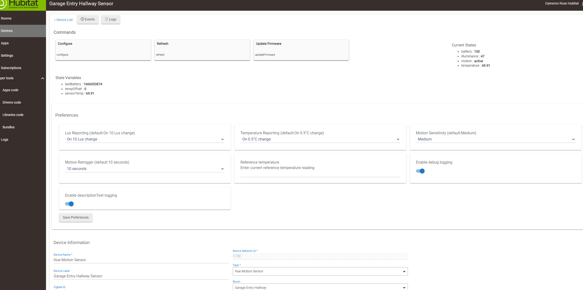

Hey guys, I just bought a few Hue motion sensors V2 to integrate into my room lighting. Those things connected without any problem to the Hubitat as a Zigbee device. That is about as far as I could get for things working as I had hoped.
I easily connected them to a dimmer as a means to activate and deactivate etc. Nothing happens to the dimmer. I checked the logs to see if motion is reported there and it doesn't seem to be. I danced around the room like an idiot to no effect. I tried this with all 3 sensors, and no motion seems to be reported in the logs. When I check under device, it says motion "active" along with the temp and luminance etc.

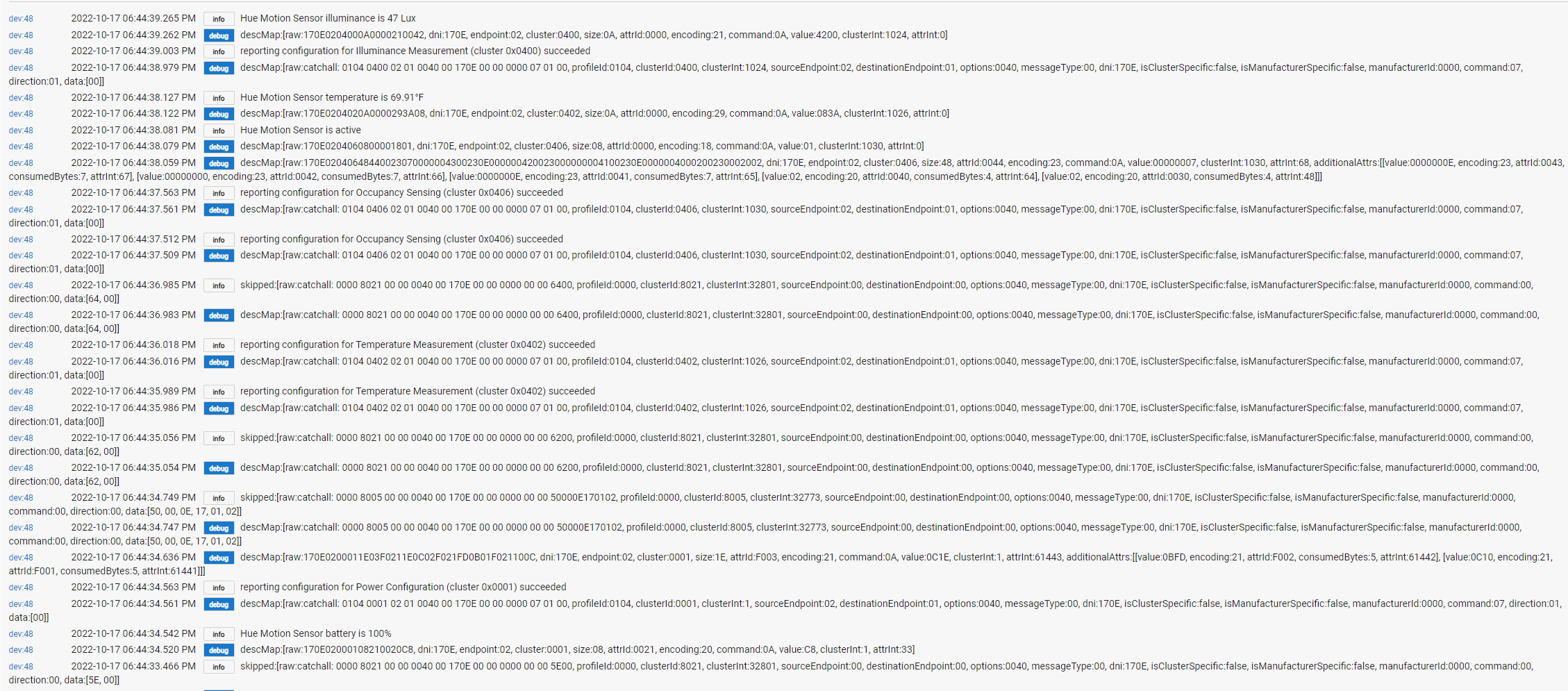

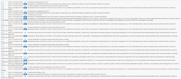

Here is the logs for the sensor.
It doesn't appear to have logged anything for the last 25 min or so even though there is plenty of motion in the room.
