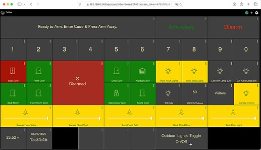

Goal: I want to able to turn ON all exterior lamps at Level 100 using a toggle tile and/or button controller and when toggling OFF have the Dimmer Level revert back to its previous setting.
At the moment I am using the "Room Lighting" app in to do this.
Dashboard at Stage 1.
Dashboard at Stage 2 having selected "Outdoor Lights Toggle" tile or via Hue Button.

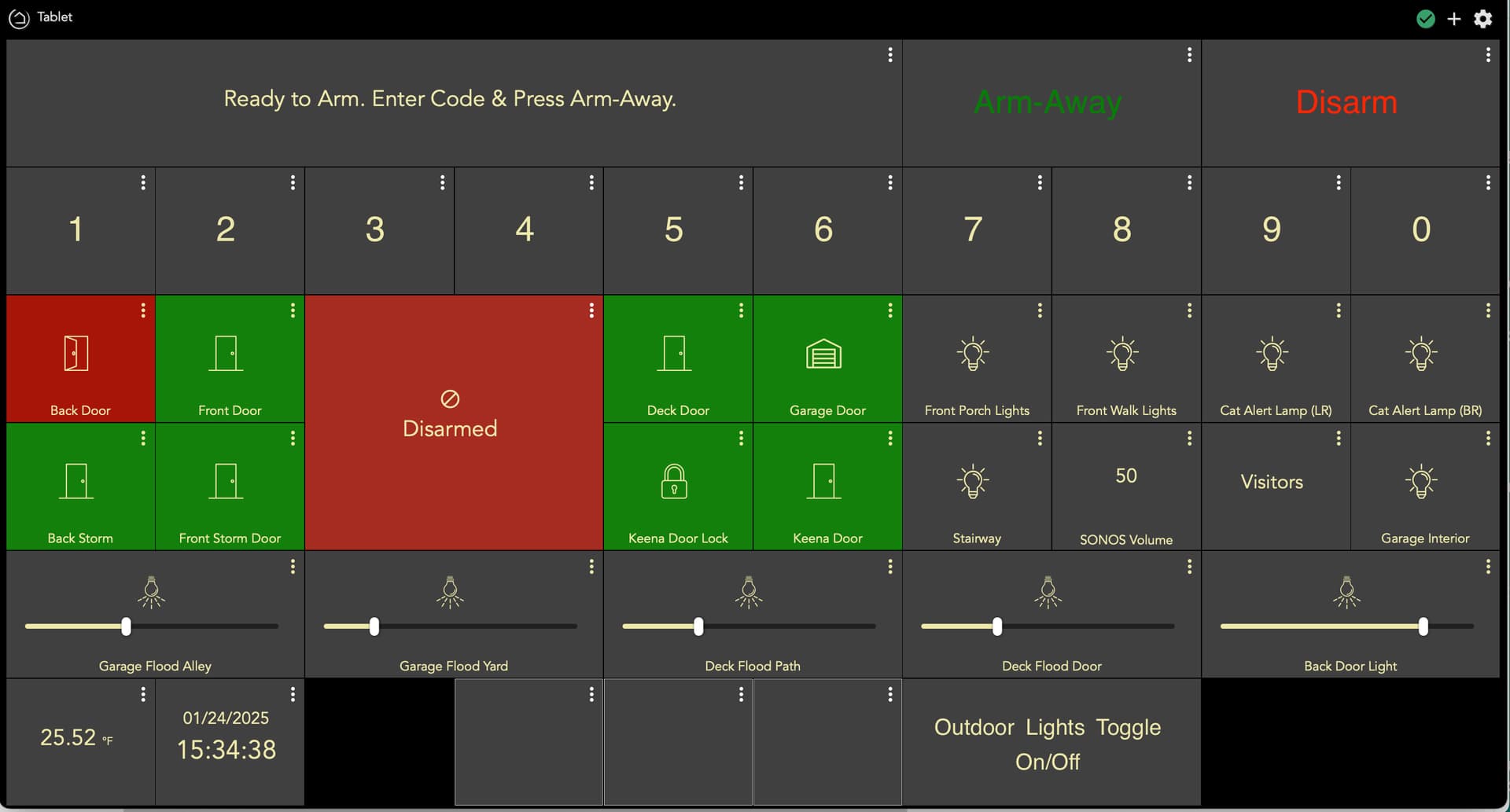

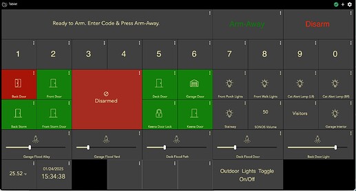

Dashboard at Stage 3 after selecting "Outdoor Lights Toggle" once again (OFF).
I am close but I would like to get back to Dashboard at Stage 1.

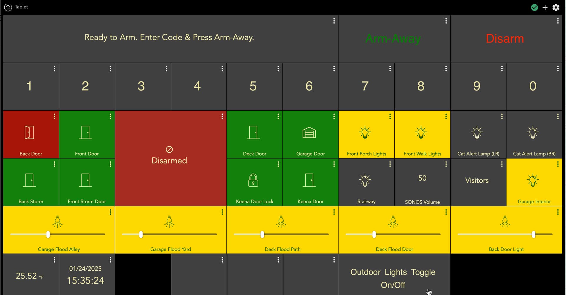

Dimmer Level Set and Lights OFF
Presently I am able to set the Level but the lamps remain lit.
