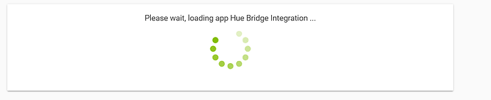

Hue integration stuck spinning in 2.4.0
Looks like I'm stuck in the spinning wheel mode. I've left it for a while but no progress. Anyone else facing this?

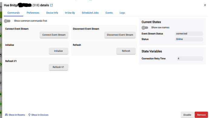

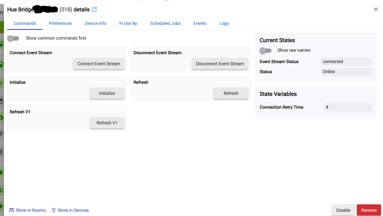

Here is what the details say on the Hue hub child device:

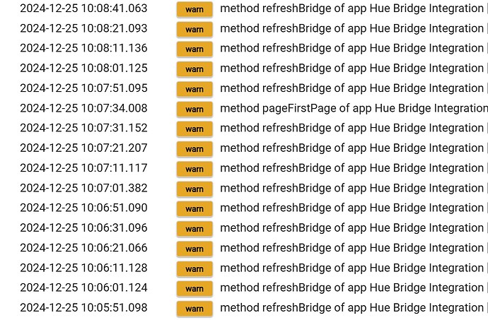

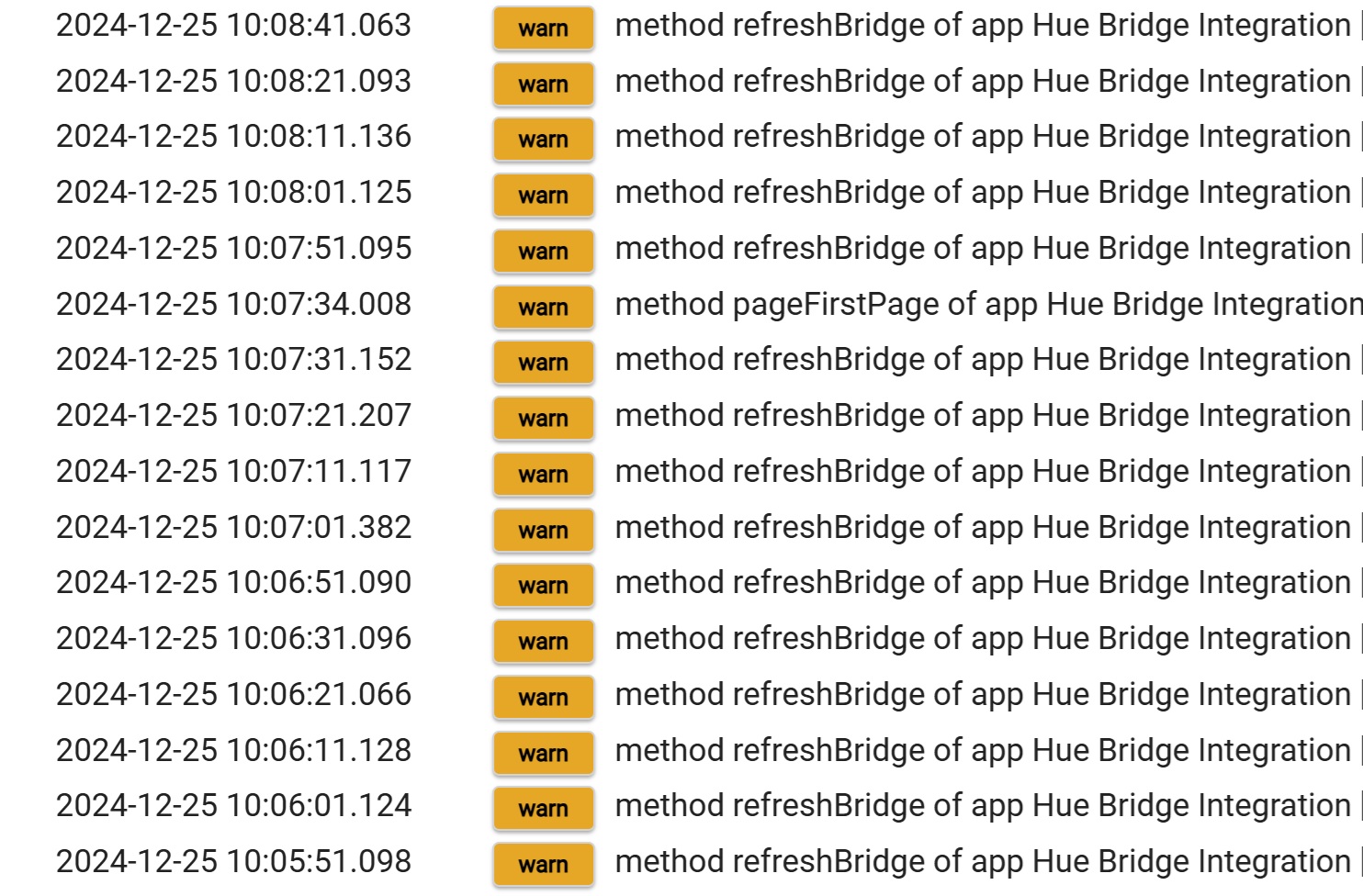

Unfortunately I'm getting the same issue, also getting hundreds of warnings
Any ideas how to rectify this? I'm running a C8 Pro on platform version 2.4.0.143
