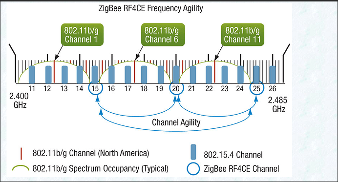

Could you have a neighbor with strong wifi nearby? Since you’re on channel 3, their router would probably also have selected a non-standard wifi channel. 20 is only between channels when wifi channels 1, 6, and 11 are used.
Is there a table I can find which channels are optimal to work with the others? Which zigbee channel works best with Wifi channel 3? Also I cant remember when I set up the hubitat if it can connect via wifi to my router but it is hard wired in with ethernet.
I run 4 UniFi wireless access points in my home, alternating 2.4GHz WiFi channels 1, 6, and 11 across them. I also limit their radio frequency range to 20MHz, to avoid RF overlap.
IIRC, the Philips Hue bridge only allows 15, 20, and 25 as its Zigbee channels. This is to help avoid WiFi 2.4GHz interference. My Hue bridge is set to Zigbee channel 25 for the Hue bulbs I have paired with it.
I use Zigbee channel 20 on my Hubitat hub and no interference issues whatsoever. I also have ~8 Zigbee outlets spread through the house to help provide a strong Zigbee mesh network.
