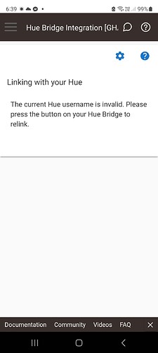

In the Apps list it states the following "Hue bridge intersection [hue name (123456)]". Once clicked all you get is the message in the photo.

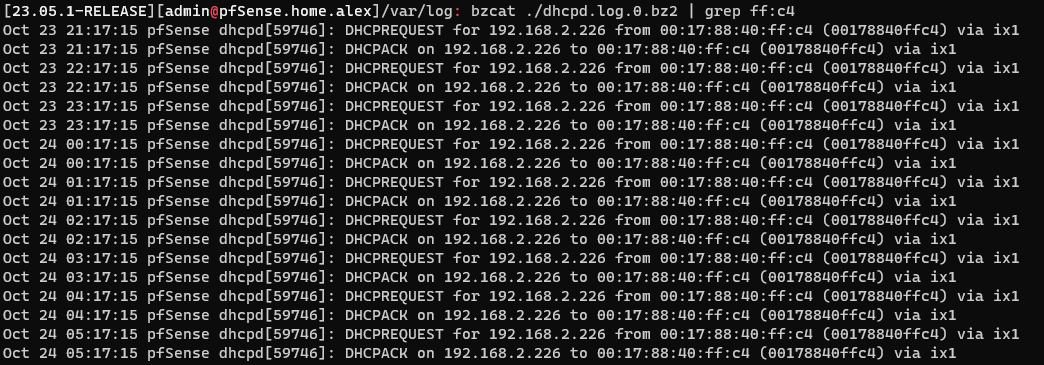

Just to make sure my router wasn't changing the IP, I checked the dhcp logs:
IP hasn't changed either.

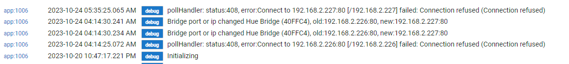

Checked over hubitat logs, and noticed this:

I understand hubitat trying the other hue bridge's IP address to see if it will work, as IP addresses can change on some networks. What I don't understand is why it doesn't swap back to the original IP if that step fails.
