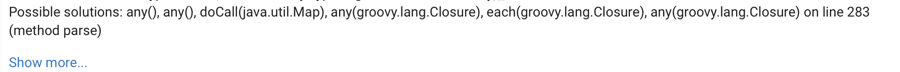

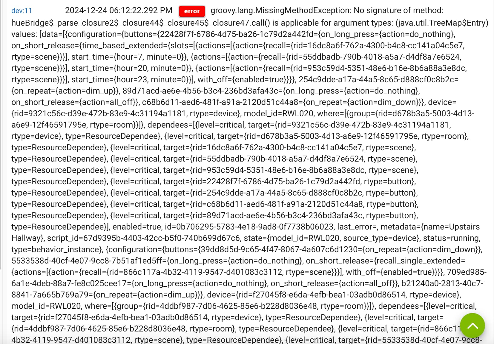

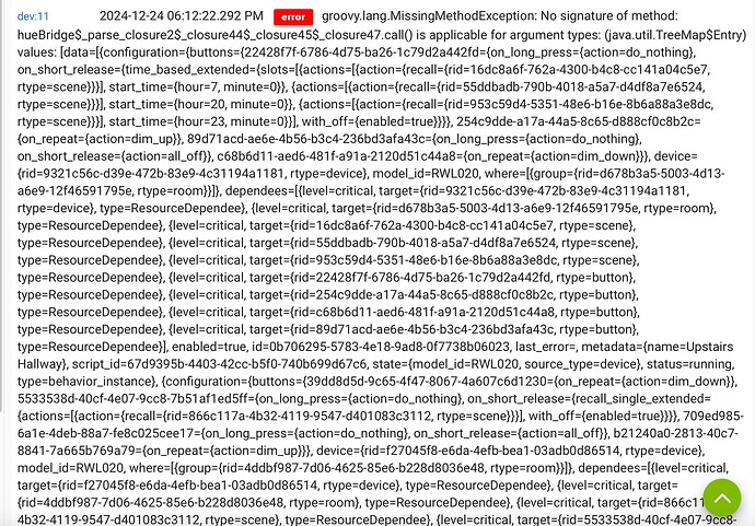

So, I was going through the screen capturing off the debug log to post here for you (it's very large). You had asked about line numbers. At the very end of the log, I saw this.
I can send you all the screen captures of the log if you would like as it does show DNIs for all the devices, etc. But there are a lot of screen captures as it is very large.
Can you share the full entry, including the entire text plus the source (device or possibly app where it originated, and the driver name--the one piece you won't find in any of that)?
For the logs with DNIs, the most interesting things would be anything that ends with a one or two digit number instead of a long GUID-looking string (assuming you are using the V2 API). Otherwise, it's probably mostly long and boring, but something that's there to more easily catch odd cases like that. :slight_smile:
I'm sorry, I'm not sure what you mean by " (device or possibly app where it originated, and the driver name--the one piece you won't find in any of that)".
As for the whole log. It is quite large. There are 33 pages worth of captures. Even combining them into one pdf is still over 18MB. What is the best why to send?
The driver name is "Type" on the device detail page. The rest should be apparent from the parts of the log entry that were cut off in the screenshot above (I.e., the full entry, including where it came from, is most helpful, not just the line number or snippet of the error).
