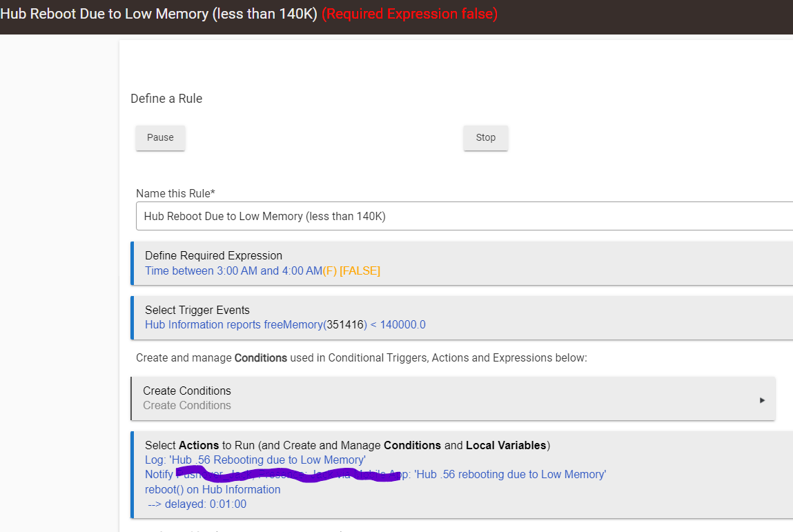

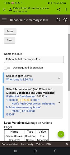

Here is mine. I like this because it does a single check at a specified time. This could prevent added stress on the hub at a time other system intensive task could hit. The previous rule will check every collection interval during the time window that is good for the required expression. If you have it collect memory frequently that could possibly cause allot of extra load.

This topic had me look at my hubs. They where not slow or unresponsive (yet). I log the information in InfluxDB. The C7 freememory flattened out at 110K and I started seeing a lot of excessive load messages in the log. Similar for the C8 at 170K. Both after running for about 75 days. So I now added a reboot if the memory drops below 120 or 180K respectively and see what happens.
@user4390 I would use @thebearmay 's excellent hub information driver., Write a rule that if the hub falls to <120000 of memory that the hub reboots and after reboot using a hub event rule sends a message to your phone that the hub rebooted. This would confirm what's going on.
