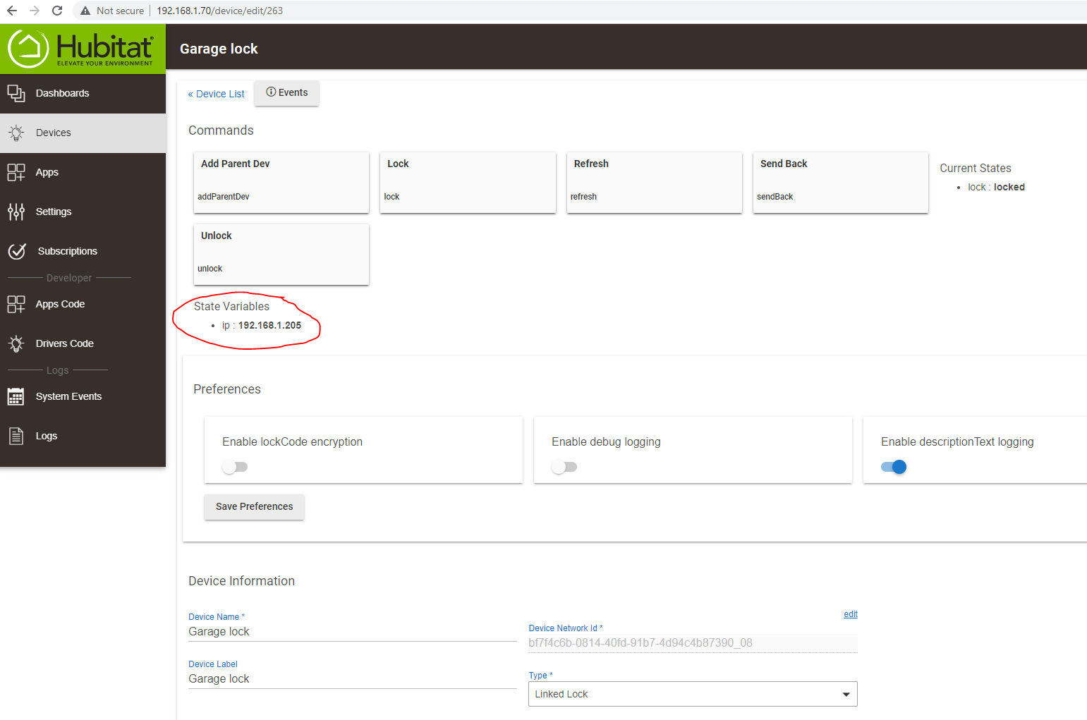

My problem is that the IP address on my "linked hub" has changed but the IP address for the devices connected to the linked hub has not (attaching pictures where you can see that the linked hub has IP address ....206 but the device "garage lock" have IP-address ....205).
I can't find any instructions about how to resolve this...
As a complication I have a ISP provided router that does not have the possibility to assign/lock IP addresses to clients, so every once in a while the IP-addresses will change :frowning:
