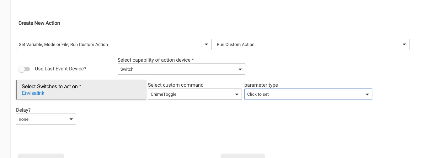

Looking for some help on how to automate the chime feature of my DCS security system which is integrated into Hubitat using Evisalink and working! I basically want to be able to toggle the chime feature on and off at a time of day and I am sure there is some way to do it I just need help from someone smarter than me. Thanks in advance

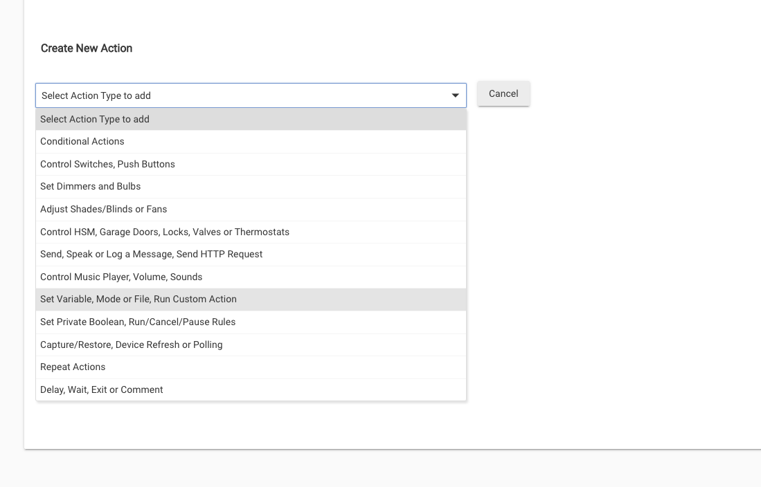

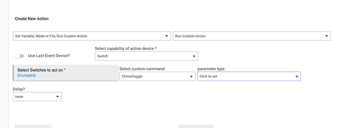

You can create a rule and use custom action to toggle the chime.
I knew someone would have this!!!! This is in Rules Machine.... perfect figured it out.
