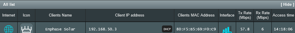

Being on the DHCP list does not mean the device is connected to the router. That only means that if it connects, it has an IP address reserved. On my ASUS Router, it would be on the Client List from the Router's top-level status page (see below).

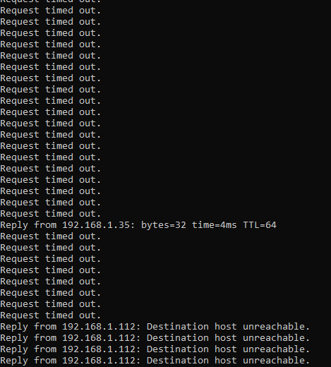

However, when I connect the hub back to the network, I lose communications, can't ping, can't get the website etc. But if I put a dumb switch between the hub and the main switch I can get comms no problem. What is going on?
If I keep ping running, I get a very occasional response when connected directly to my main switch. No chance with the web interface.

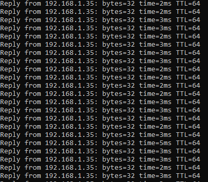

But when I use the same cables and put an extra switch between the hubitat and the main switch I get a consistent ping.
