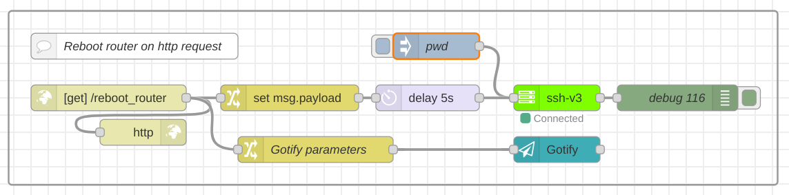

Here is a flow where the hub calls a HTTP endpoint on Node Red which executes a SSH command on my router to reboot it:
The "PWD" node at the top is just there to test that it works. When I trigger that, the debug node outputs "/root". The two nodes at the bottom send me a notification when the reboot is called.
I have a similar Node Red flow where, when the hub gets notified that my systems are running on UPS, it makes a HTTP to Node Red that runs a script on the Raspberry Pi to shut down the Pi. In that one I used an Exec node to run the shell script instead of as SSH command.
So you can directly run SSH from Node Red, or you can use Node Red to run shell scripts. They can be triggered by HTTP calls, or you can use Node Red Nodes for Hubitat (node-red-contrib-hubitat (node) - Node-RED) to trigger off of device state changes on the hub.
