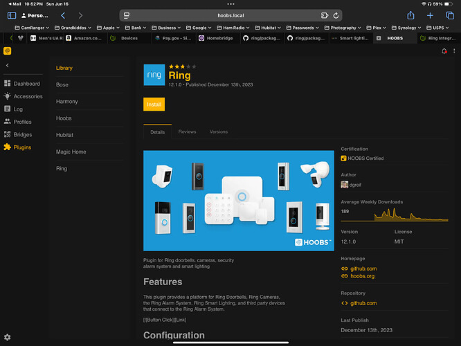

I have a hoobs / home bridge. However I can’t get the ring to install.
Sorry, I don’t have experience with Hoobs. I just run HomeBridge in a Docker container and the Ring plugin works well.
I know Hoobs is built on HomeBridge, but I think some of the plugins are unique. You will probably have better luck working through their support forum to solve that problem.
Thanks all for your help. After a bit of work I imaged my HOOBs SD Card and started all over and everything is up and running. Ring is in the Home App and running great. Thanks.
