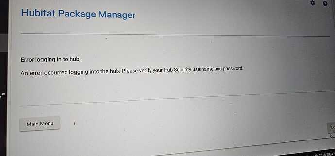

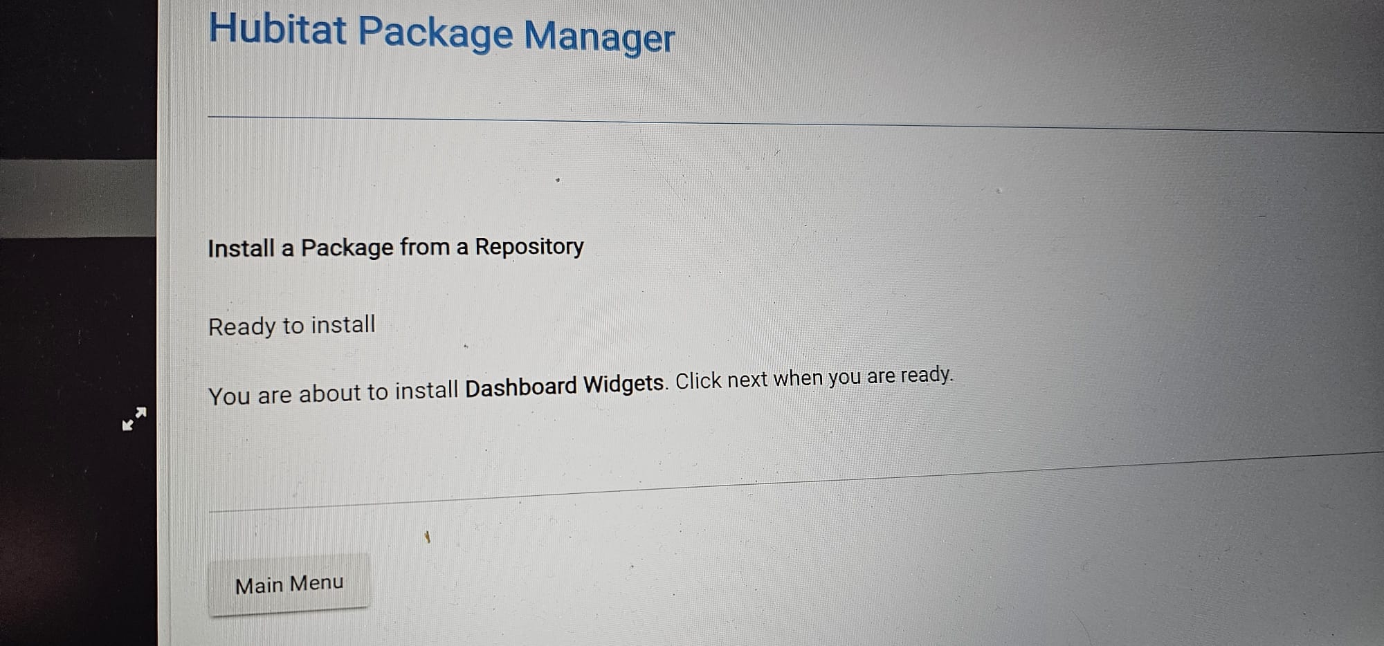

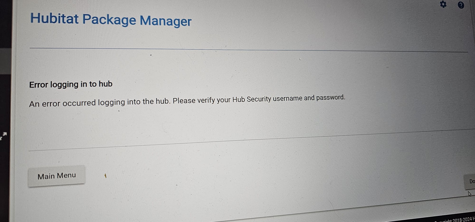

When I am trying to install a package from a repository, I get an error message:
error logging in to hub,

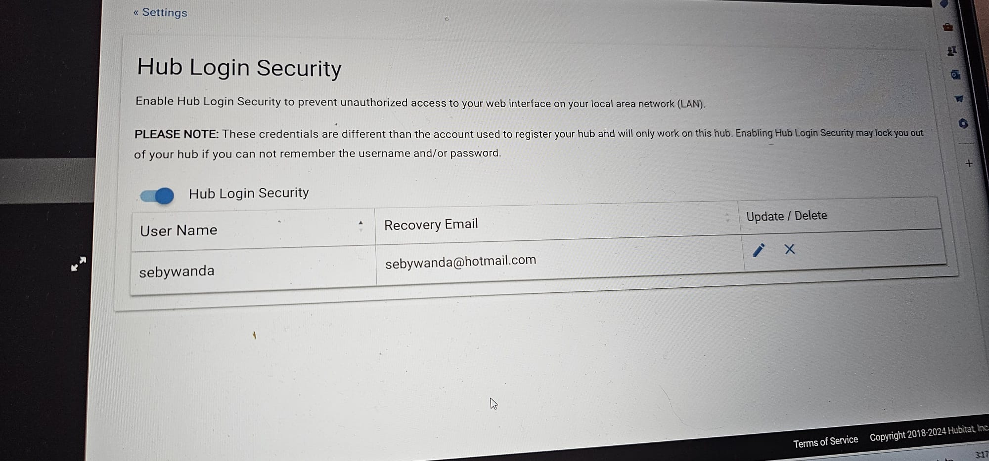

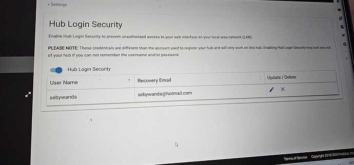

Do you have hub security enabled on your hub?
If so, the error message is telling you to enable the security settings in HPM settings.
it is enabled
On both?
Are the same credentials entered in the Hubitat package manager app’s interface?
I see it is enabled on your hub, what about within the HPM app?
thank you.
That was the issue. I just updated the login info and it worked.
