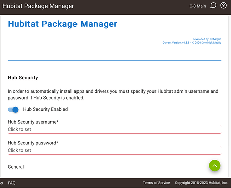

Trying to install Echo Speaks via the Hubitat Package Manager.
I click on search by keywords and I found Echo Speaks by Anthony S. And I click install.
After clicking “ready” twice it says that it is installing and will take a few minutes.
THEN COMES THE ERROR:
Error logging in to hub
An error occurred logging into the hub. Please verify your Hub Security username and password.
So I go and log in using my hub security username and password but nothing changes.
Any ideas?
You need to enter your username and password into HPM so that it can authenticate to the hub.
Many thanks! Kept going to the actual security hub, didn’t realize there was one in HPM!
