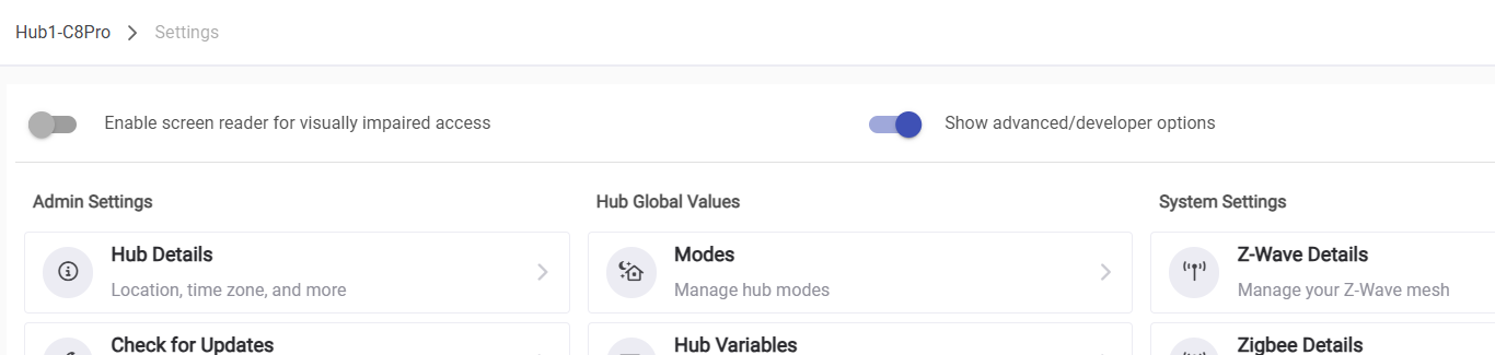

Sounds like you are talking about the "Show advanced/developer options" toggle on the Settings page. On new/fully reset hubs that defaults to off and must be toggled on to enable access to those capabilities.
Thanks - I had not set that, but it is now.

I did follow your advice and found that the Bundles section reappeared (as did drivers) and I was able to import a .zip bundle for the PM. I will continue testing, but this modest little item of the switch that you showed is the real key to a clean/new-ish HE coming alive.

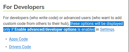

I assume you mean "HPM" or "Hubitat Package Manager" (I am not familiar with anything called "PM" or "platform manager"). This is a custom app. Documentation for how to use and install these is not and cannot be provided by Hubitat other than the general instructions applicable to all custom code, which you will indeed find in the user interface documentation, among other places:
"These options will be displayed only if 'Enable advanced/developer options' is enabled in Settings"
This may not be apparent if you don't know what to search for, so hopefully this helps. Each link there is also a link to another page with more information about that UI page.
