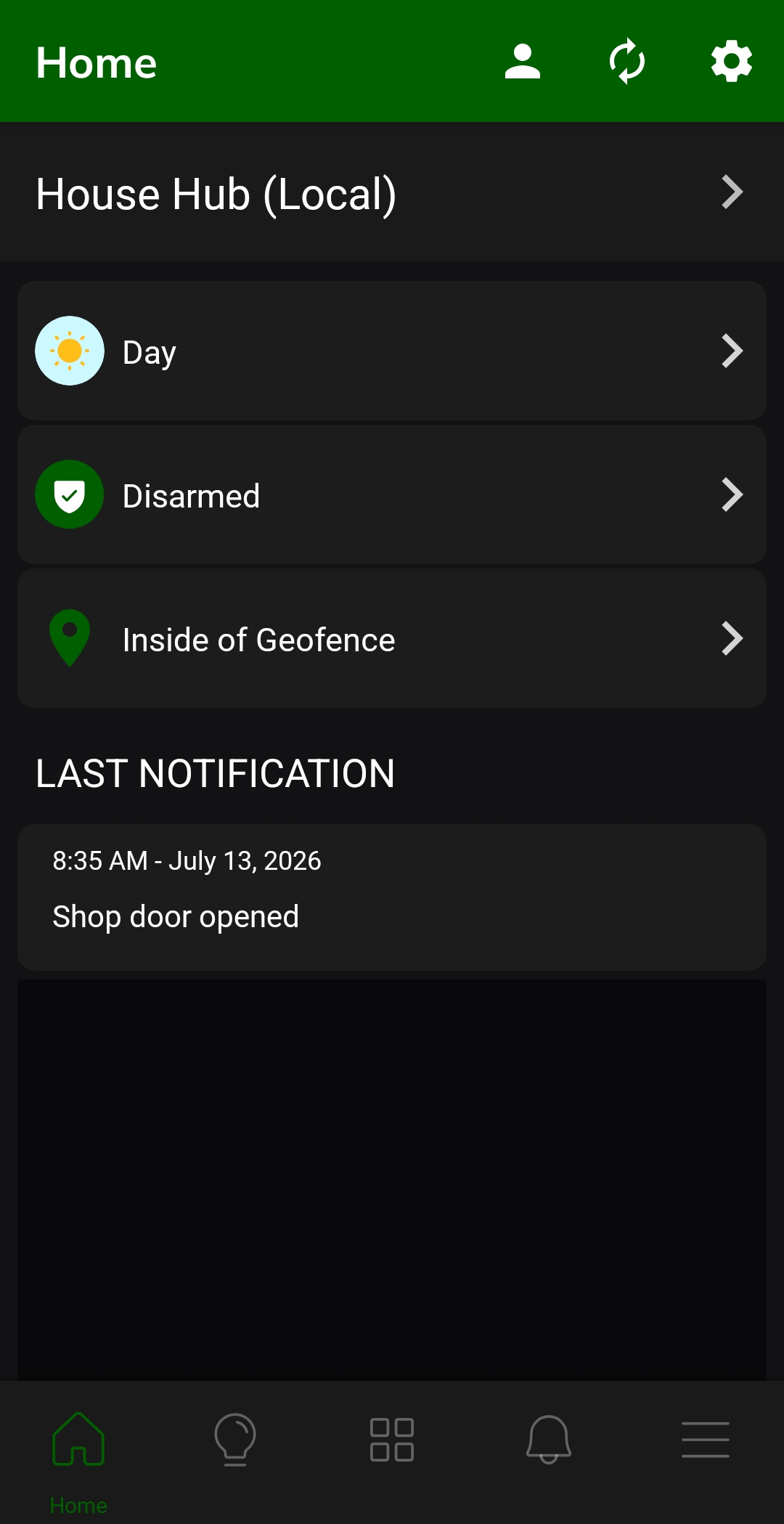

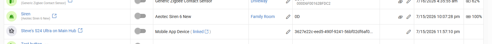

Randomly, when I’m home, my presence in Hubitat changes to not present which of course triggers some events (especially if my wife is also away). When I look at the Hubitat mobile app, it shows I’m in the geofence (and I am) but when I look at the presence device in Hubitat (associated with my GS24) it shows not present.
I have found that if I go into the Hubitat MA Geofence setting and just slide the slider to a bigger then smaller radius that seems to trigger something that corrects the situation and I can see the presence device in hubitat return to present at the same time. Note that it doesn’t return to present if I just open the app, which implies the app wasn’t sleeping.

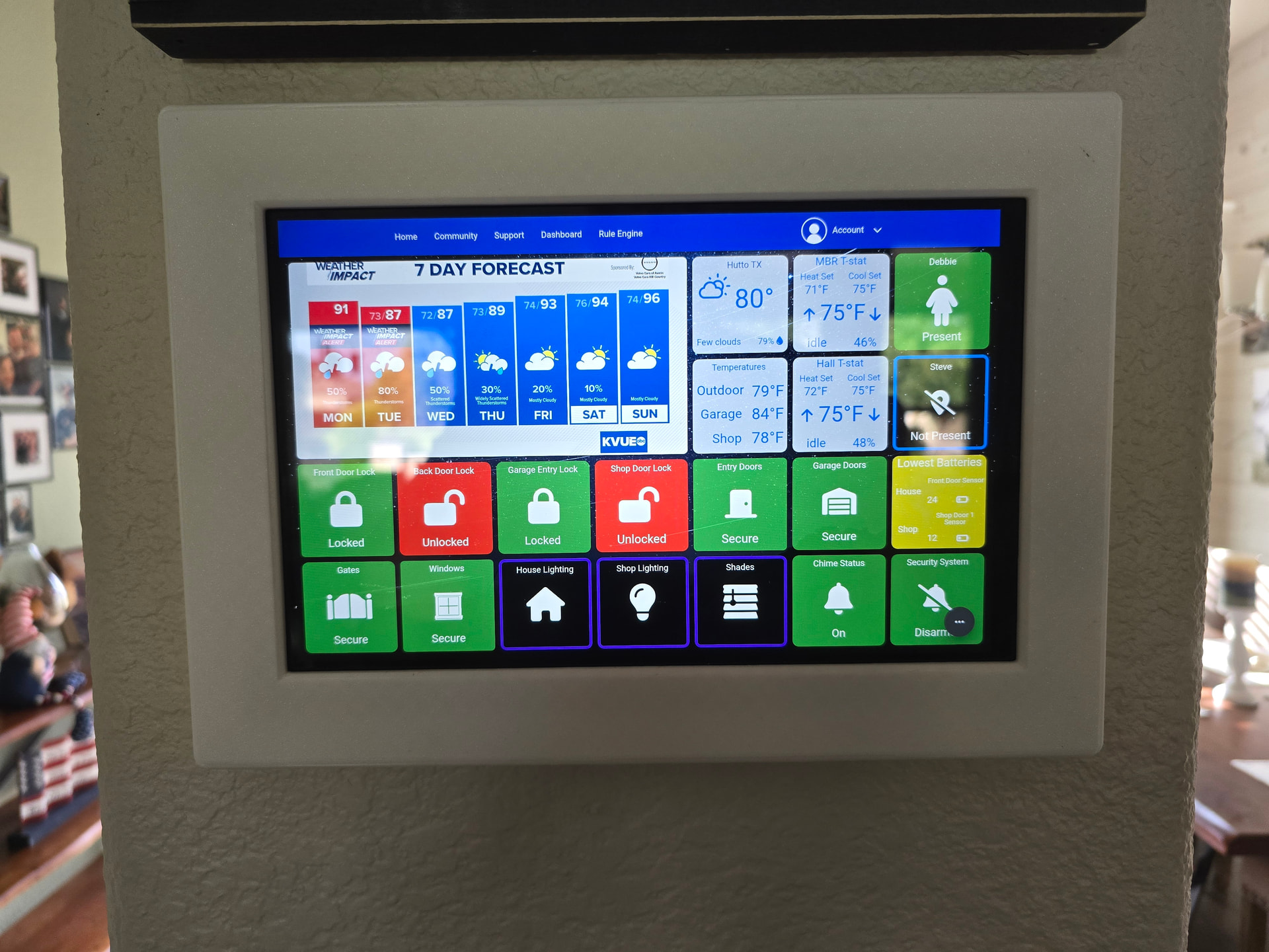

I’ve also included a picture of my Hubitat MA showing me inside of the geofence, a pic of my Sharptools dashboard at the same time but the tile in the top right (Steve) shows me away. Also I have the picture of the Hubitat presence device showing me not present.

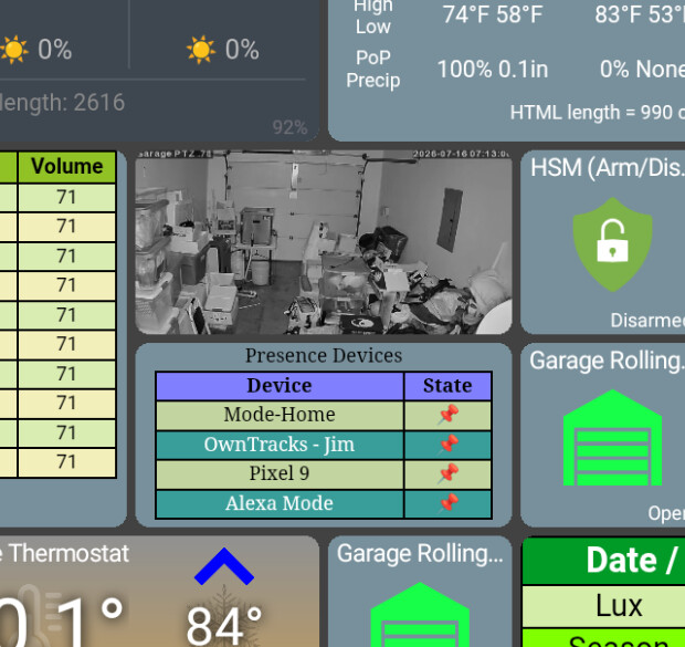

The dialog and threads in HE Community are long on this subject - and I can’t offer help about the mobile app - I’d like to suggest an alternative? Owntracks is a huge value to my presence features both in dashboards as well as function. I do get good function of presence on my newest Pixel 9, but my previous Pixel 8 was about 50% correct. I track multiple home/away presence but Owntracks is my truth.
Thanks, I’ll investigate that other approach. I’ll go with anything that works.
