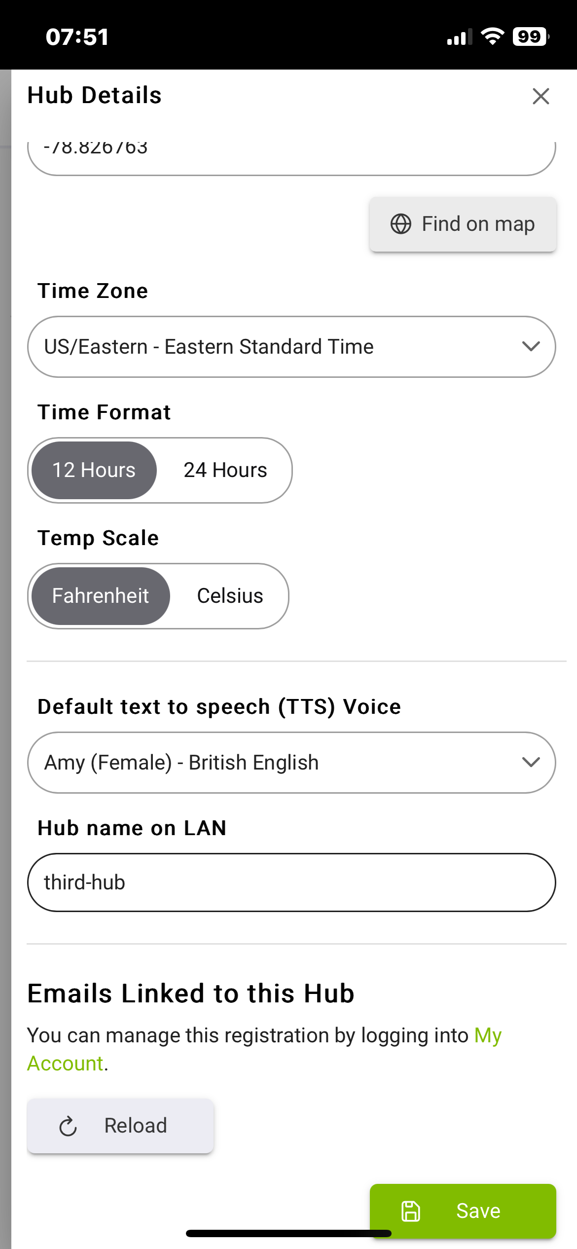

Maybe I’m missing something, but I’m not seeing any problems with reaching any of my hubs by using this method. Each of my hubs has a different .local name, since I have 3 hubs (main-hub, second-hub, third-hub). Have you used the name of the hub as it appears on the Settings page under the Hub Details tab?
For example, typing “third-hub.local” into the address bar takes me to my third hubs home page.
