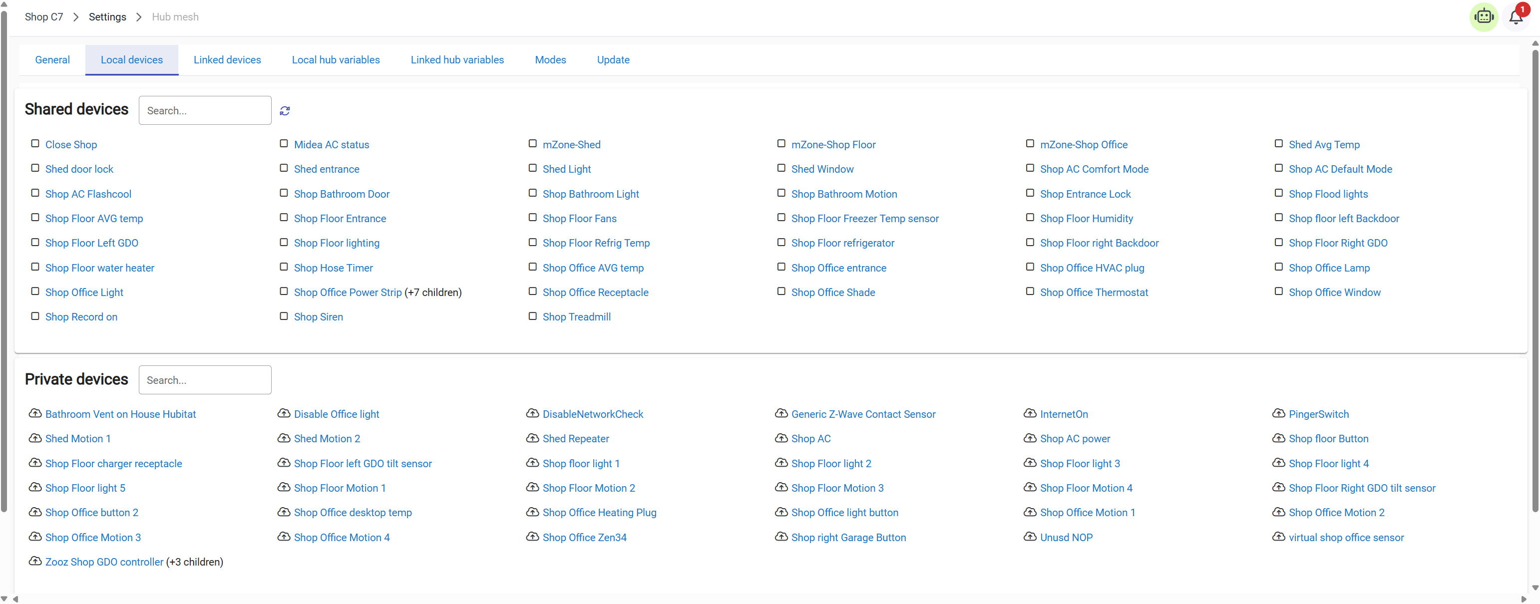

Should go to local devices and share the ones you want. Here is that page from my shop which I share these devices with my home hubs.
Thanks, I’ve done that, but I don’t see them on the other hub.

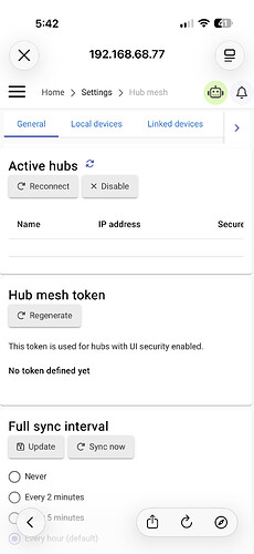

On the general tab under settings>Active hubs do you see all your hubs listed?

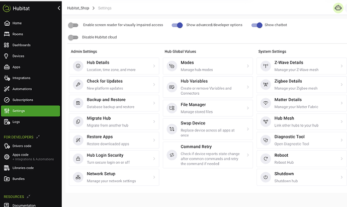

Under settings, I don't have a general tab. Here's what I see.

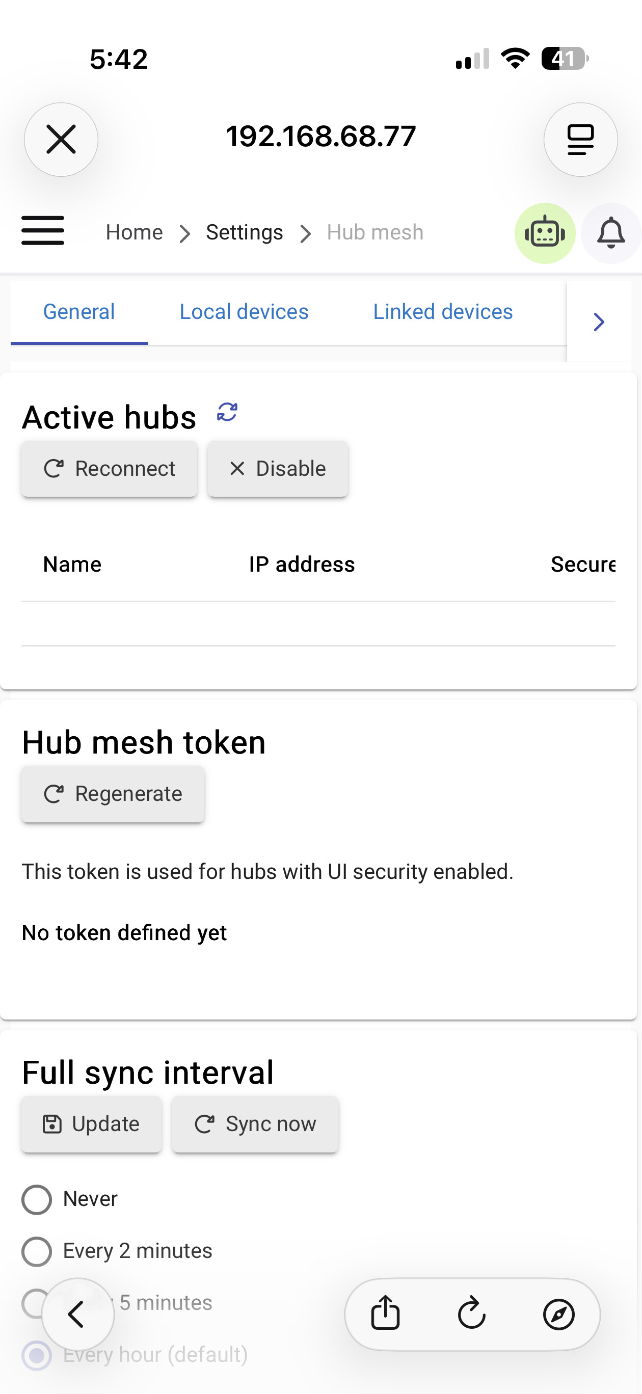

Ah, I think you mean settings / hub mesh / general?
If so, no, I don’t see other hubs. Could that be the issue?
Click disable then enable again then reboot. Make sure nothing is blocking mDNS on your network.
