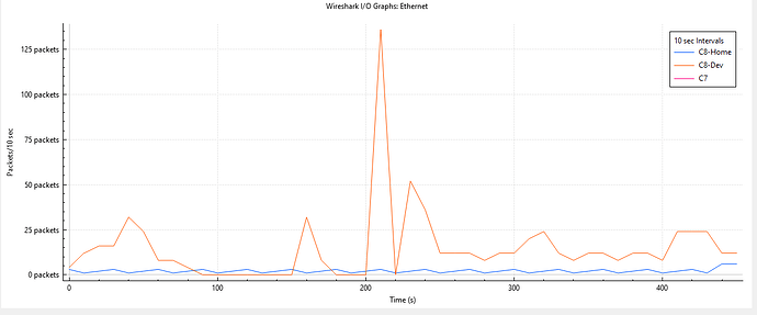

Maybe there IS a packet storm upon initial start of the service? Anyone checked? If one time during hub startup, it might just be overlooked.
Just tested it, pretty insignificant. I started the capture before clicking reboot, the largest spike should be around when it booted back up.
I also have no idea what the mDNS "restart" actually does, if they are just simply restarting the service or some other procedure doing more than that. Whatever it is doing though, IMO is broken. Good riddance to turn that off finally.
Obviously restarting the mDNS via a hub reboot does not have the same effect as the Bonjour 20 minute restarts.
