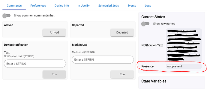

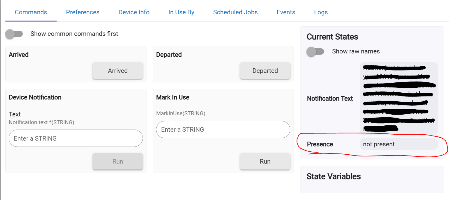

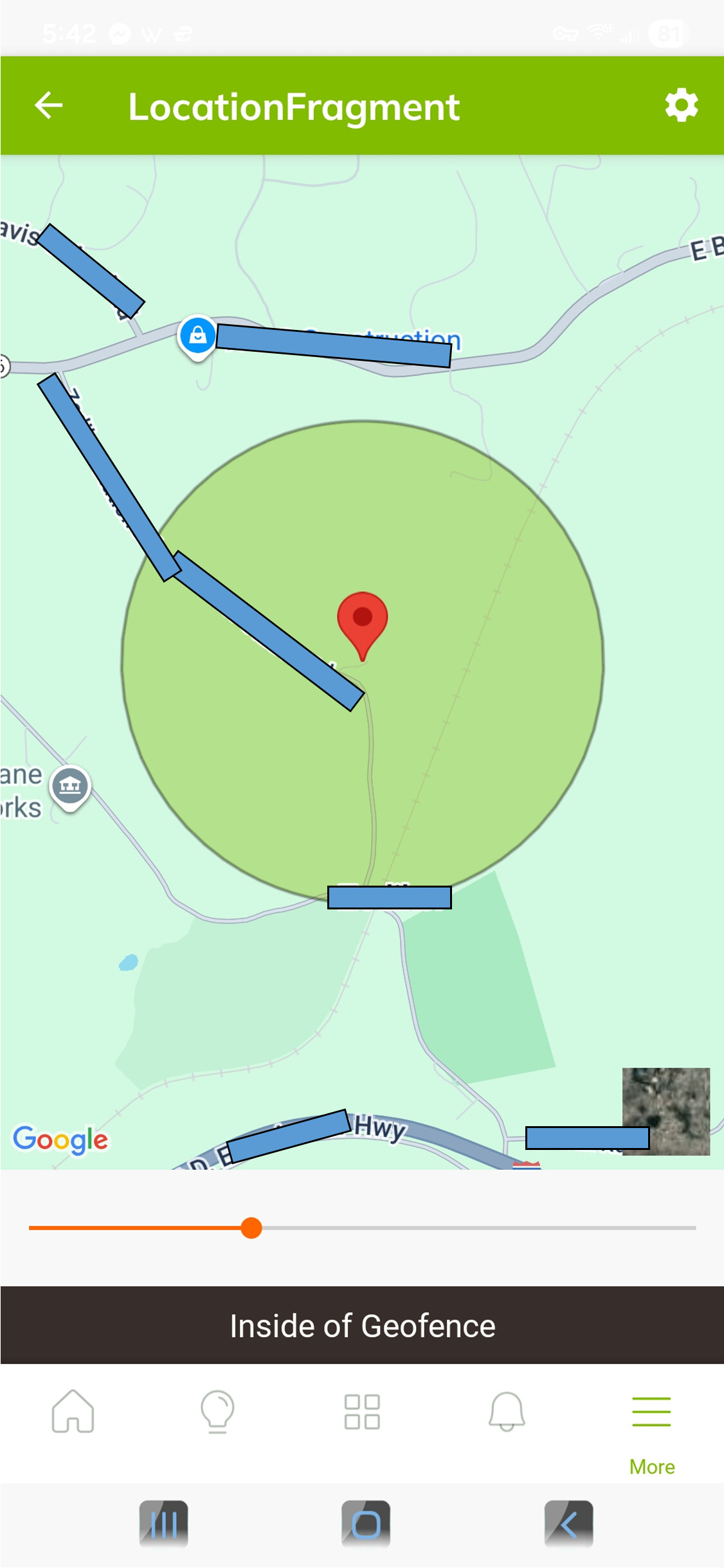

Currently phone 1 is inside the geo fence.
The device page shows it NOT PRESENT.
Obviously the virtual switch did not change to ON because it is NOT PRESENT.
If I move the location somewhere and then back, it will update to PRESENT. I've even had luck enlarging the geo fence and it will update. I'm really as large as I want to go right now.

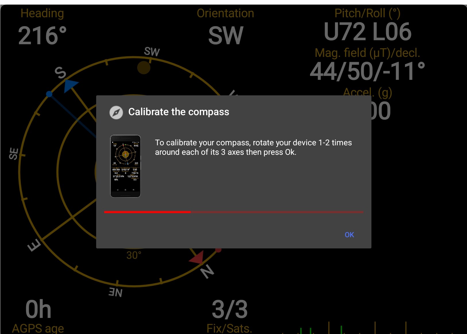

I Highly recommend that GPS status app as a first thing to check. If your compass calibration is off, then it will cause presence sensing to go haywire (I have NO idea why the Google API cannot rely on your GPS coordinates and ignore the compass. But that is what it is). I mentioned it in the above link, but I just commented again on this with a picture of a "bad" compass calibration. (If you have just recently started using a magnetic mount, or case with a magnet closure, those will kill the compass calibration almost instantly)
ALSO, one other thing I found was related to the fact that I had my boundary set at a point where my phone had no cellular or wifi (or possibly where it was switching between the two.) This was causing me to be able to sneak out of the boundary. When I actually should have been triggering the switch to out or in boundary, the message couldn't get there because I had no network. It looks like you might be in a rural area too. I fixed that by increasing my boundary to a point where I knew I had coverage out of the house. This was affecting both Hubitat AND Tasker presence and might have been happening long before I realized this was also an issue.
I installed this and checked. It was green to start but I re-calibrated anyway. We'll see what happens.
My geofence is about a half mile. We do have sketchy cellular, but not bad enough to drop calls. My WIFI is strong and I can be outside and 300 feet away from the router and still have it.

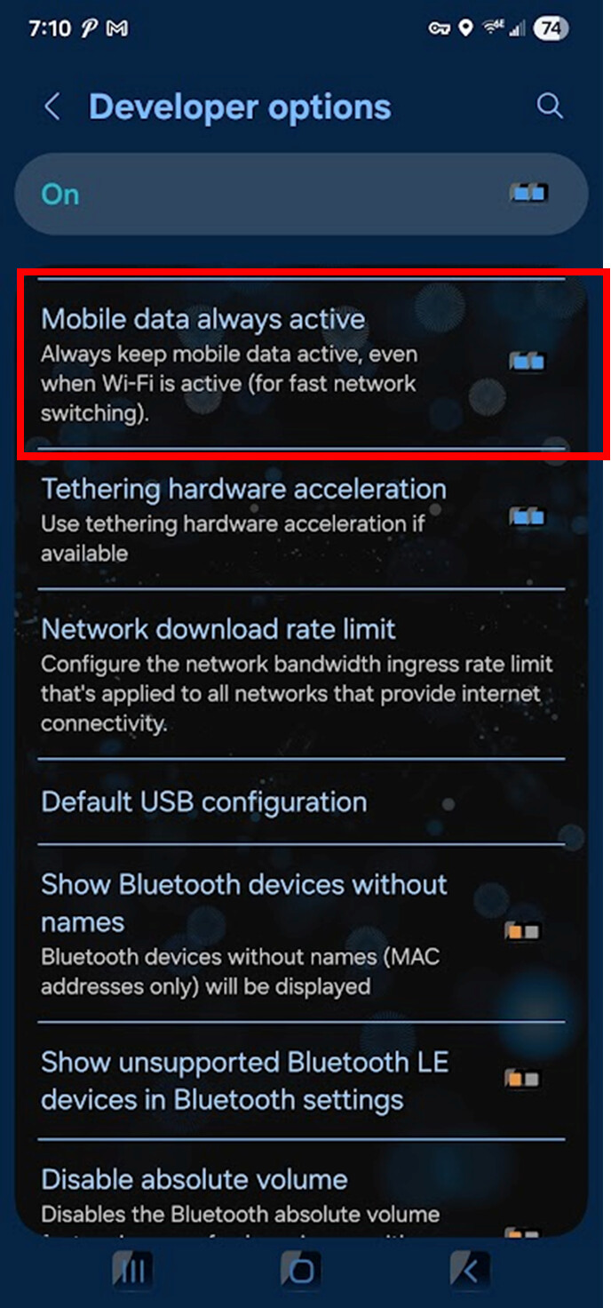

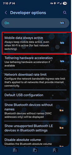

I'm going to also try this. I turned ON Mobile Data always active. Might help with the scenario you mentioned about times it is switching...
Doing this on phone 1, not phone 2. I'll see if this makes a difference.

So far on phone 1, I took @tray_e 's advise and recalibrated the compass. Then I turned ON Mobile Data always active. So far (only a couple hours), phone 1 is staying present where phone 2 changed to Not Present 2 hours ago. It has been sitting on the counter for the last 4 hours.
