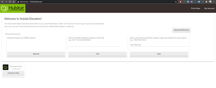

@bobbyD Why I can't see this menu when try to access the device, the port 80 is not working and the port 8081 only show the ribbon and no menu is showing at all
That's very odd, mind posting a screenshot of what port 8081 shows? I've never seen that one before.
Yes sure,
Is very important, let you know that this is a brand new, I did open the box, and then when tried the setup, did have it
Is it a browser issue? Have you tried any other browser?
Yes, I did, with Ubuntu (Chrome, Brave, Firefox) , MacOS (Safari, Chrome, Firefox and Brave), finnaly with Windows 10 (Chrome, Edge and Firefox) and no luck.
Thanks for the screenshots. It looks like you've had the hub in the box for quite some time, because the Diagnostic Tool has changed a long time ago. If you didn't do so already, please send us an email at support@hubitat.com with your hub's MAC address as well as purchase order details.
