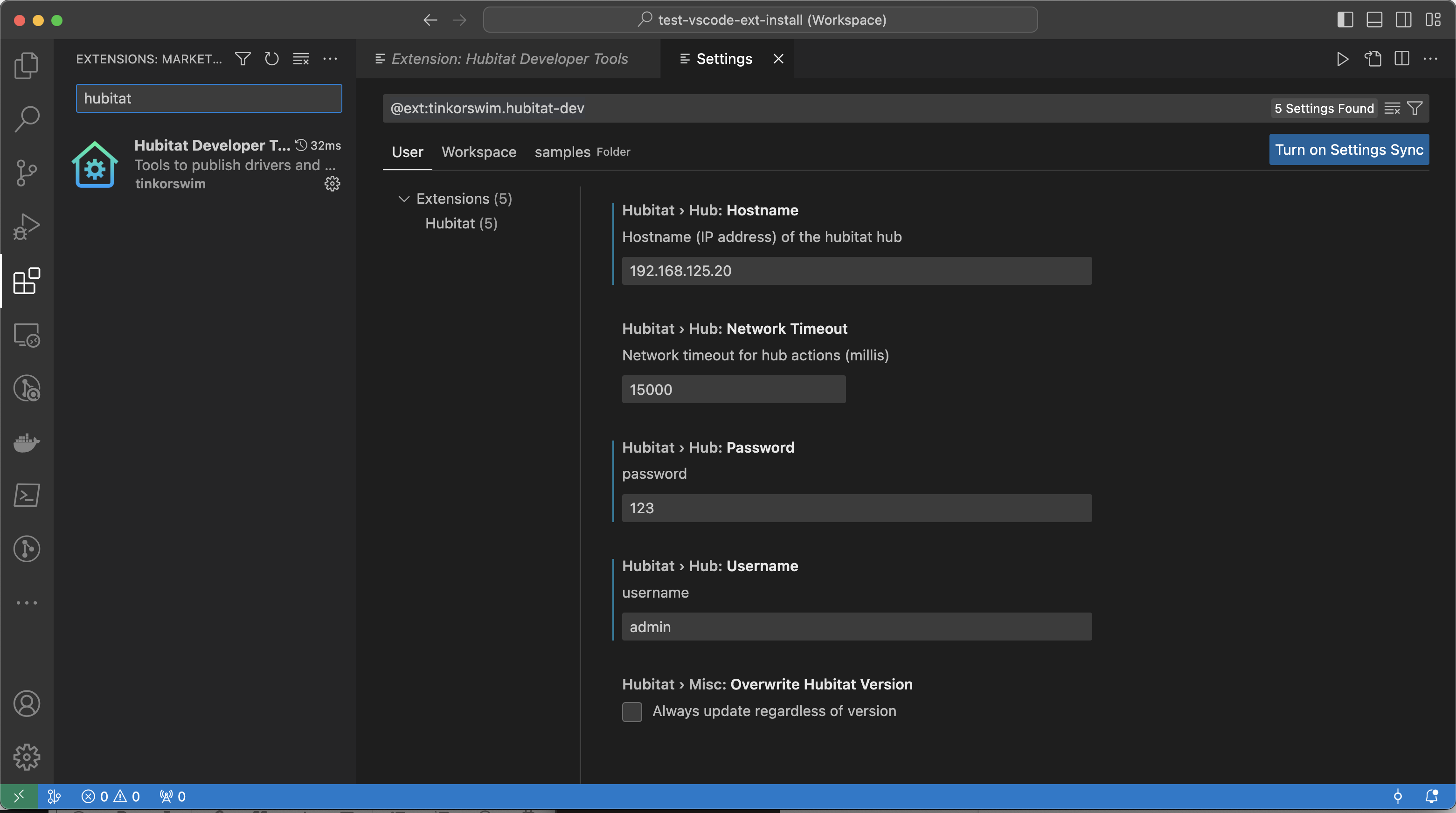

added a configurable network timeout to the settings, default is 15000ms (version 0.0.17)

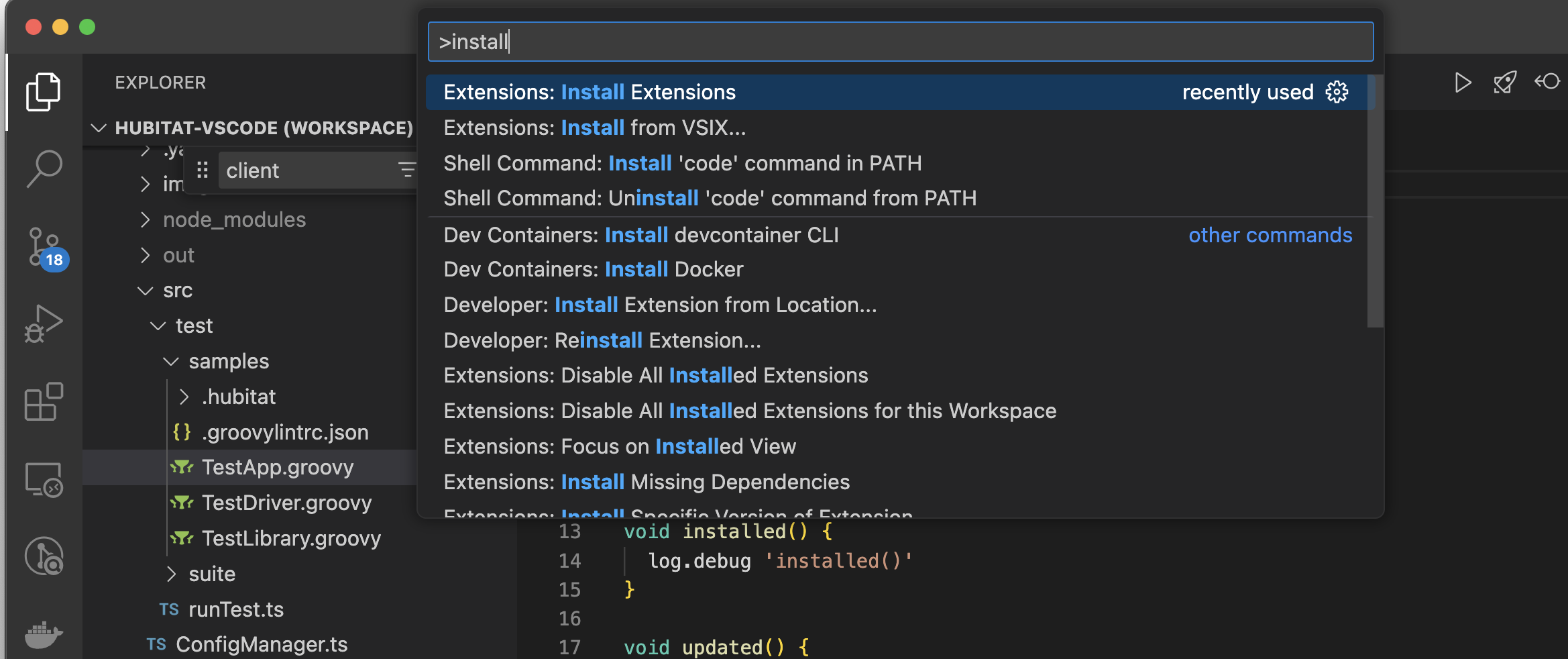

New Install instructions..

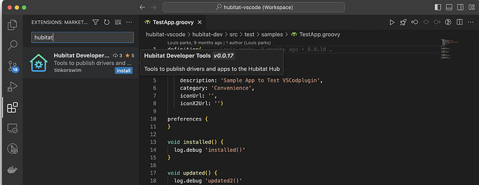

  1. While in VSCode, type in Control-Shift-P (Command-Shift-P) and then start typing “Install Extensions”.
  2. Select “Extensions: Install Extensions”.
  1. Search for Hubitat in the Extension Marketplace
  2. Click on install

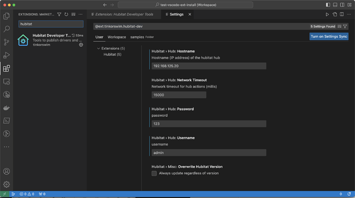

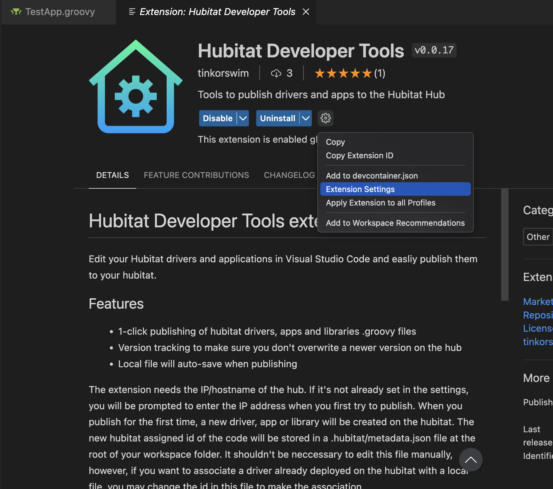

  1. After the extension is installed, click on the gear icon as select "Extension Settings"
  1. Enter the hub address and credentials if hub security is enabled

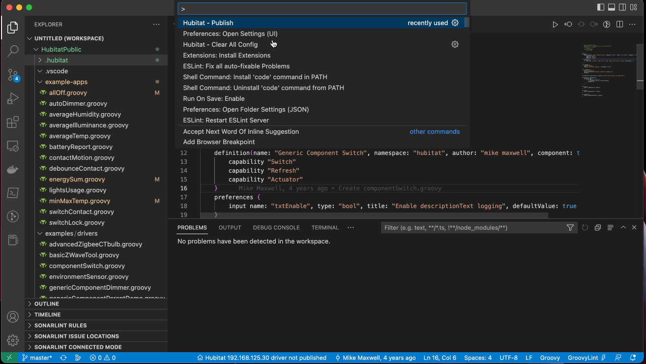

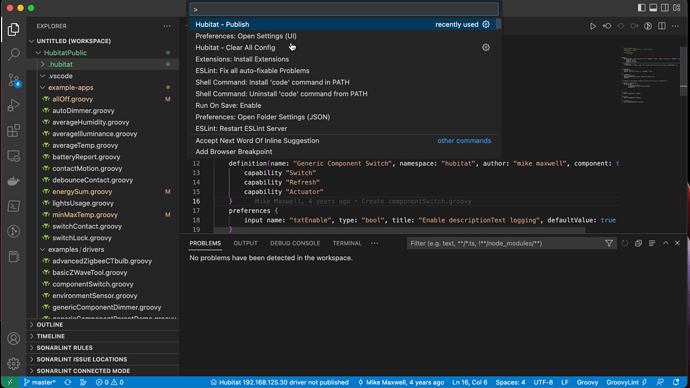

  1. With a driver or app open type Control-Shift-P and this time type in Hubitat - Publish. You will be prompted to enter the current id of the driver or create a new one. After hitting enter you driver will be published and reloaded on the hub.
I updated to the new version through VSCode. I installed the new one first then removed the old version and my hub settings even carried over so that was nice.
Also, wanted to point out for anyone new, when you go to run the publish action from the menu I HIGHLY suggest clicking the little gear by it and setting a special Hot Key, I have used Ctrl-Alt-P myself for publish. So I can work on my drivers, hit the hotkey and then within seconds the code is pushed to my hub!
