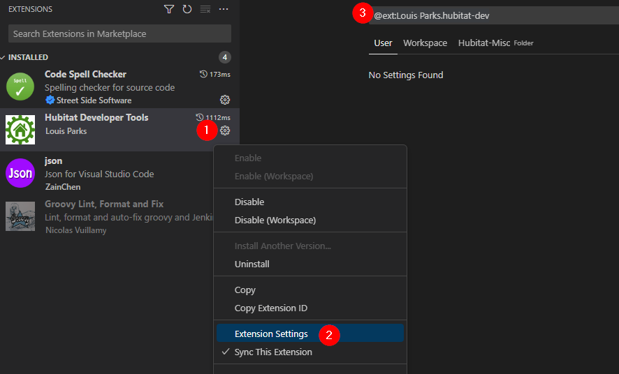

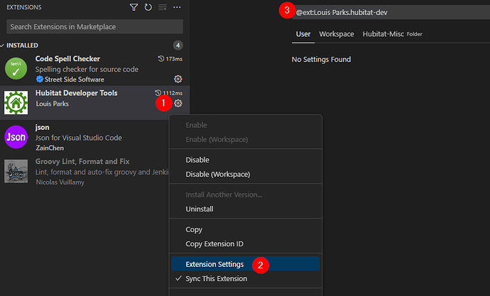

This is just cosmetic really but someone else pointed out the settings only show if you navigate to them manually. I do not use a lot of extensions but on the spell checker I have, these steps bring up its settings. On your extension it just comes up blank. Click the gear > Extension Settings. I would expect to see the settings.

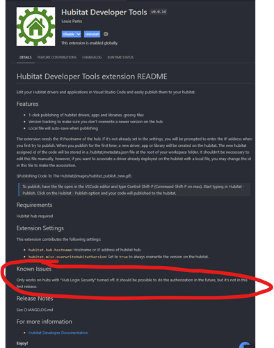

Current version does work with security, I use it.

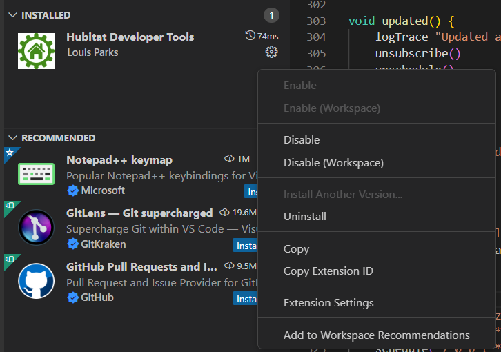

In VS Code bottom left, click the gear, then Settings.
Expand Extensions, Go to Hubitat section, fill in your username and password.
For some reason if you click the extension and hit settings it says no settings found, but if you go in that way I described above you can get at the settings.
At first it did not support it, but now it does and I turned back security on my development hub and all works perfectly, Check just above this post for how to get it setup!
Yup, thanks got it working. I think I saw some documentation still saying that it doesn't work. Might hvae been on the extension page or github - can't remember offhand, but it might need updating

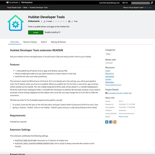

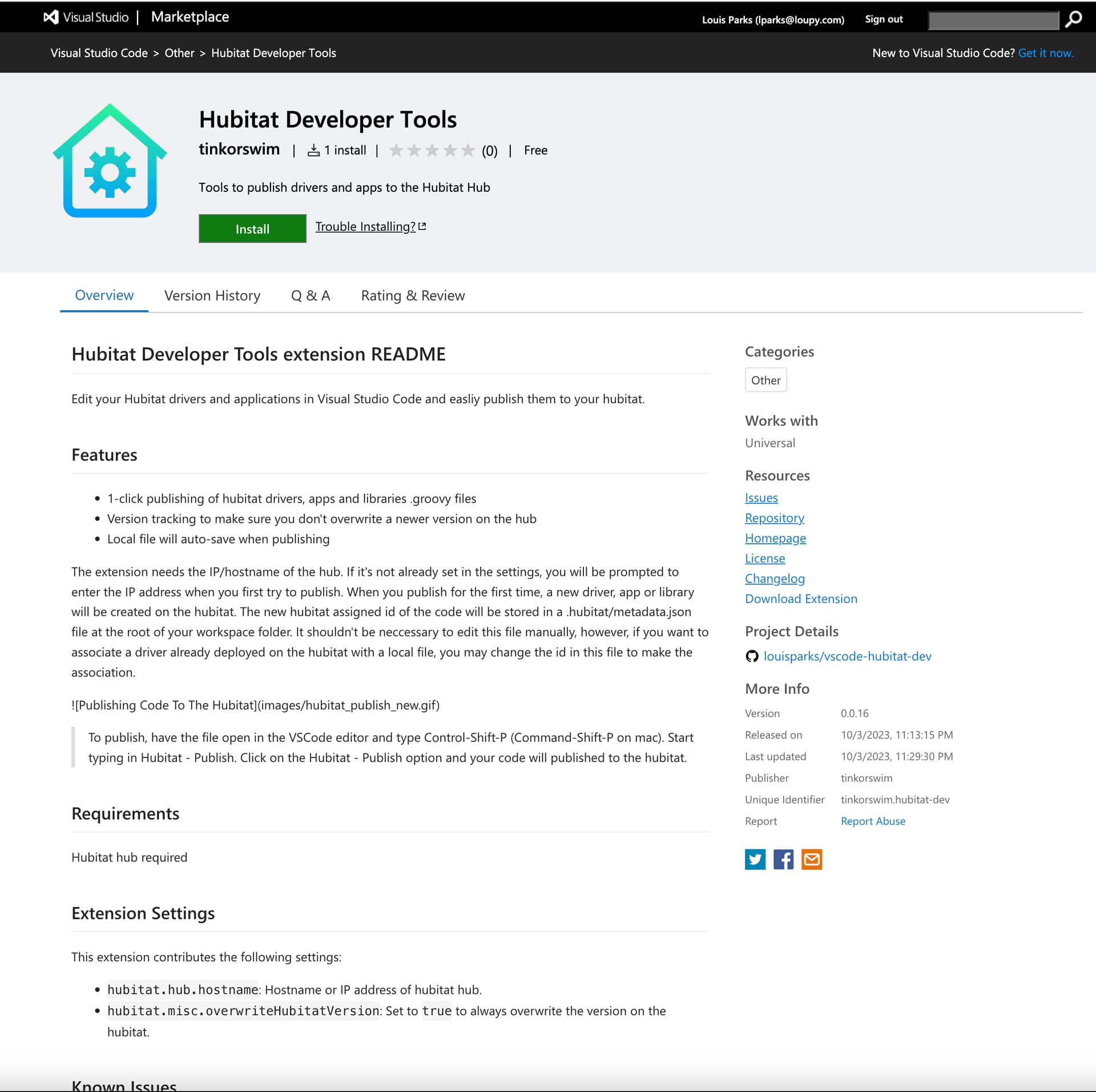

Hi All! I was back writing some drivers and decided to finally go ahead and publish this extension to the VS Marketplace. Please give it a whirl when you get a chance. Version 0.0.16 is the latest. No big changes, but I needed to update the publisher name to get the settings to work properly from the installed extensions gear icon. It should work with your existing meta datafile, but you might need to re-enter the address and credentials for the hub.
