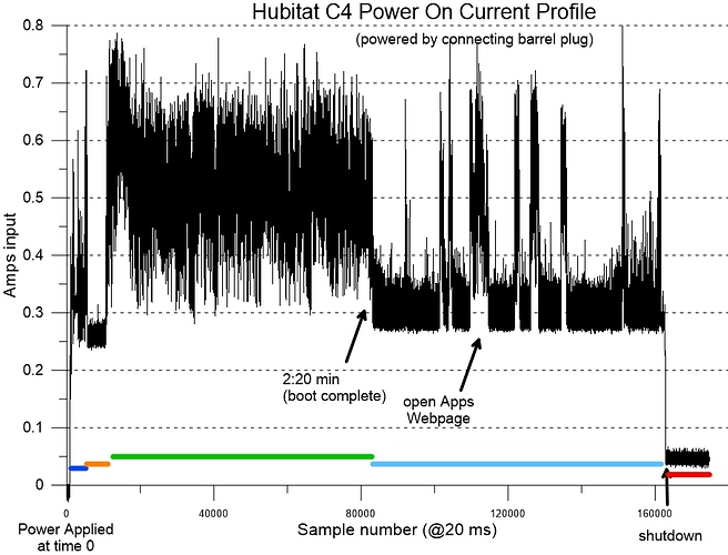

Here's the current my C4 draws on power up. Note the 5V supply is from a laboratory supply with capability of > 5 amps
Data Description:
Dark Blue line, hardware is starting up
Orange line, hardware has settled down and processor is about to start
Green line; processor booting.  This ends at 2:20 minutes:seconds (0.5 - 0.6 amps)
Light blue; processor bouncing between idle (0.3 - 0.35 amps) and active (0.5 - 0.6 amps)
Red line; processor shutdown, only power supply and red LED is active (0.050 amps)
Peak consumption is approx 0.8 amps
I wonder what the data would look like for a C-5 Hub with an external Z-Wave USB stick? I wonder if that combination would ever peak above .8A? If so, it might make sense to use a 1.5A-2A power supply.
I don't know, I only have the C4. I tried looking at what might be different with the external stick brought inside. The best I can see is the reduction of one 5V to 3.3V supply, believing the C4 has one in the unit and one on the stick.
Anything closer I would have to test a C5.

I measured the current with a LEM-15 hall sensor with a custom built circuit and board. Logging was done with a Measurement Computing USB DAQ.
