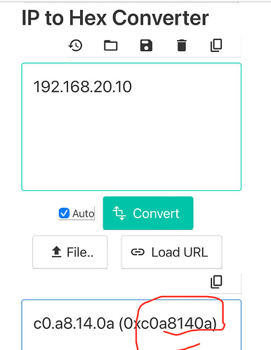

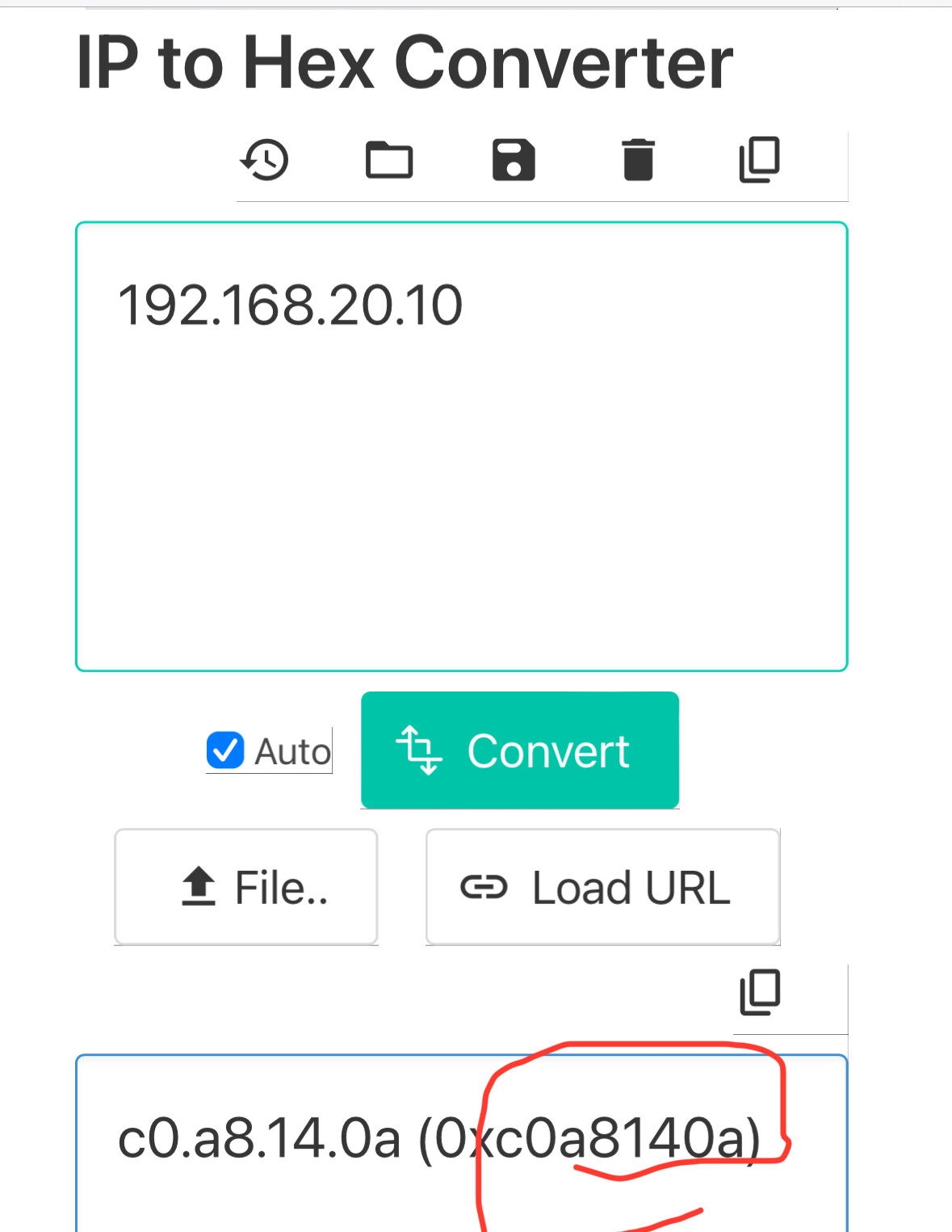

I gave up with automatic detection and just add a new virtual device, select Sonos Device as the driver, and the once added set the device network ID to the hex of the IP address assigned to the Sonos. You can use this converter to get hex of your IP:
So 192.168.20.10 would have a DNI of c0a8140a
