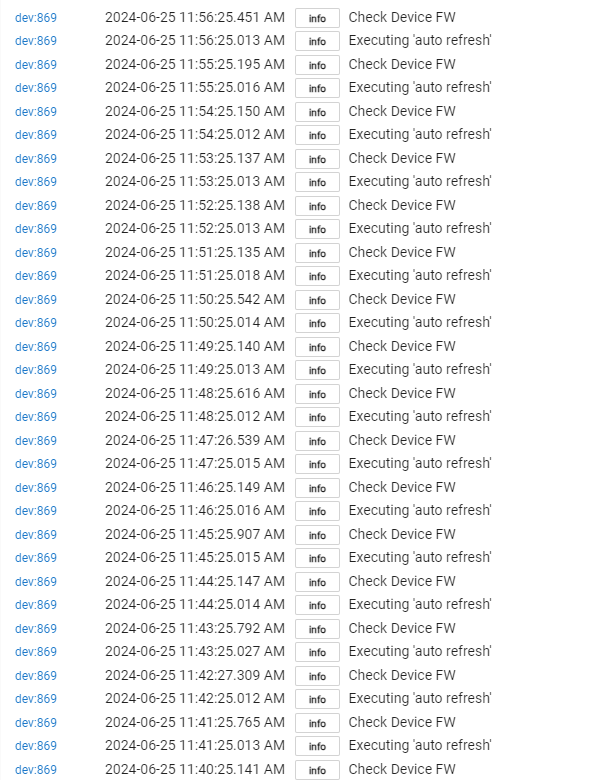

It deffo happens before the freeze up, I use a few user integrations, When I think about it the one I potentially added around that time was the shelly plus from ShellyUSA. I only have one device on that particular app. I just checked the logs for that and its being a bit demanding. I have updated the firmware and dropped its refresh rate from every minute to "manually or polling only"
I can provide a complete list of my custom apps if it is something that will help with resolving this although with the timeline I have for how long this has been occurring I suspect its going to be a short list within the venn diagram for "when did this start happening" and "what did I add about then"
