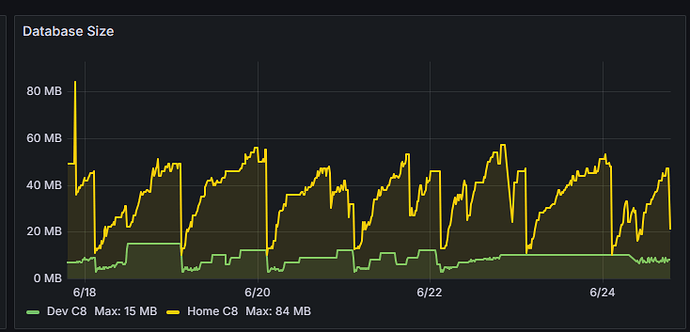

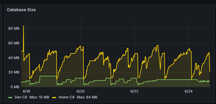

Here is my DB size over 7 days, on both an active hub and mostly idle hub (for testing). Hub is not rebooted on any sort of schedule only if updates needed. So many of those peaks and drops are not from a reboot but routine compactions done by the platform.

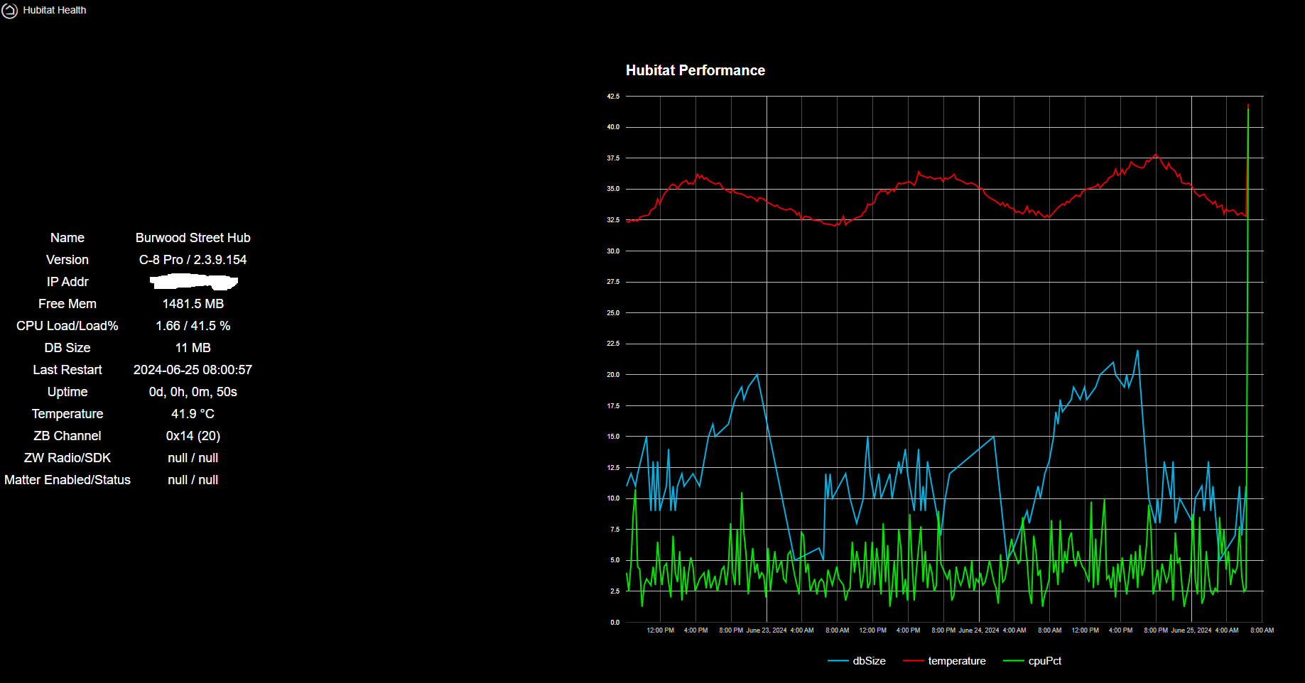

I am concerned about the spike in processor CPU pct as this seems to pre-empt the freeze behaviour. I will keep an eye on it after the DNS changes I made this morning, If / when it happens again I will try a new power supply, If it continues to happen I will try the DHCP thing. Its just weird that it was rock solid for 2 years then both the C7 and the C8 Pro have the same issue. with the same power supply and the same Network configs...

Oh yeah I see the CPU spike now, and you are sure that was before the lockup and not after rebooting? A CPU spike right after reboot is normal.
Looks like the temp spiked way up right with it, suggesting something went haywire and the CPU really was under heavy load until it overheated and locked up.
