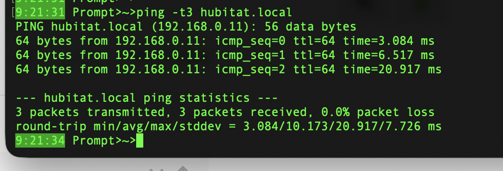

can you ping the mdns hostname (default his hubitat.local) It won't always resolve properly. The easiest solution is to put in either a new record if you have your own DNS server or simply add it to your hosts file.

Yes I can ping the Hubitat Pro which is connected via Ethernet with a static IP Reservation;

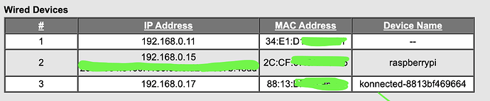

I was just hoping to see the device name, not just the MAC and IP. Here is what I see in attached devices. You can see the the device name is blank. Again I realize that this is not a router support group - just throwing this out there because I know others are interested in the same.
It's primarily because of MDNS. Can you annotate in your router?

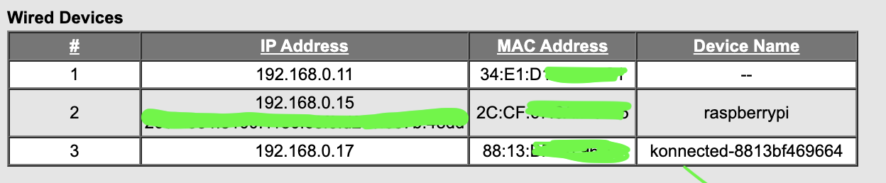

Edited your post to remove the screenshot with the hub’s MAC address. Not a good idea to expose it.
Thanks aaiyar. I reposted with MAC redacted.
